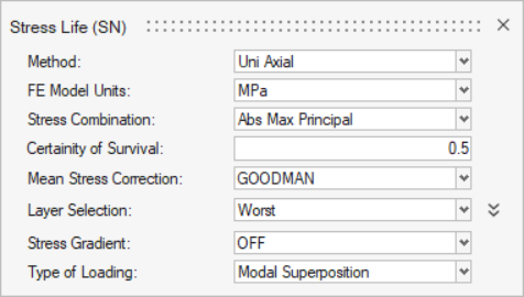

  2. Define the SN configuration parameters.
    1. Select Uni Axial as the method.
    2. Select MPa for the FE model units.
    3. Select Abs Max Principal for the stress combination
    4. Enter a value of 0.5 for the certainty of survival.
    5. Select GOODMAN for the mean stress connection.
    6. Select Worst for the layer selection.
    7. Select Modal Superposition for the type of loading.
    Figure 5.

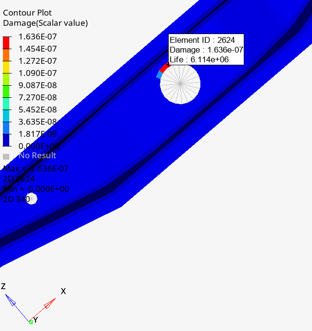

  4. Once the run is complete, click View Current Results.
  5. Use the Results Explorer to visualize various types of results.
    Figure 13.
