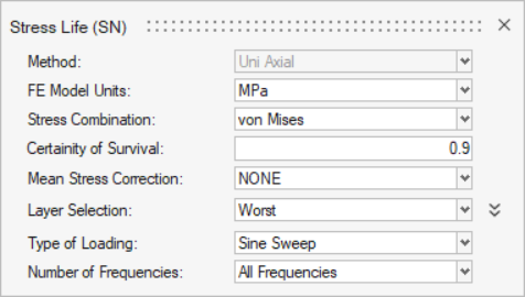

  2. Define the SN configuration parameters.
    1. Select Uni Axial as the method.
    2. Select MPa for the FE model units.
    3. Enter a value of 0.9 for the certainty of survival.
    4. Select NONE for the mean stress connection.
    5. Select Worst for the layer selection.
    6. Select Sine Sweep for the type of loading.
      von Mises is automatically selected as the stress combination.
      Note: Only the von Mises stress combination is supported.
    7. Select All Frequencies for the Number of Frequencies.
      This considers all the frequencies from the frequency response subcase.
      Note: Alternatively, User Input can be selected if a certain number of frequencies are to be considered between the first and last frequency, or Frequency Increment if frequencies from the frequency response subcase are to be selected based on increment.
    Figure 6.

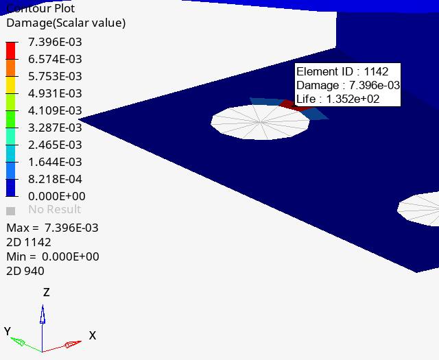

  4. Once the run is complete, click View Current Results.
  5. Use the Results Explorer to visualize various types of results.
    Figure 14.
    Figure 15.
