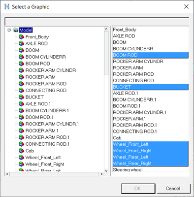

  1. Use the collector to pick the graphics/body/AutoTire that will interact with the bulk material in EDEM. When selecting using the Body collector, all valid graphics associated with the body will be selected. Graphics of type Box, Cylinder, Sphere, Ellispoid, CADGraphics, FileGraphics can be selected from the graphics area.
    • Use the Body collector to select a flex body (CMS).
    • AutoTire can be used to transfer a Pratt-Miller flexible tire. Refer to the Tire - Entity documentation to learn more about setting up a flexible tire for co-simulation with EDEM.
    Tip: Use the Select a Graphic/Body dialog to pick multiple graphics simultaneously (double click on the collector to display this dialog).
    Figure 3. Select a Graphic Dialog
    Note:
    • This functionality currently supports the following graphics: Box, CADGraphic, Cylinder, Ellipsoid, File (mesh-based graphics such as H3D/OBJ) and Sphere. Any other type of graphics selected using the Advanced Graphics selector dialog will not be used and a warning message will be displayed.
    • Selected graphics that have no bodies assigned will be highlighted in red in the list. Such graphics should be removed from the list before transferring the geometry to EDEM or creating the EDEM system.

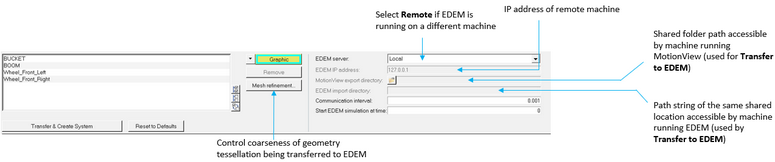

  2. To control the coarseness of the tessellation of the graphics (CADGraphics and Primitives) that go into EDEM, click the Mesh Refinement button.
    Maximum facet width ratio Maximum width of elements in meters.
    Curve chord tolerance factor Tolerance factor that controls chordal deviation along curved edges.
    Surface plane tolerance factor Tolerance factor that controls surface deviation along curved surfaces.
  3. Select the EDEM server:
    1. Local if EDEM are running on the same local machine as MotionView and MotionSolve.
    2. Remote if EDEM is running on a different machine.
      1. EDEM IP address - Specify the IP address of the machine where EDEM application is running. Default is set to 127.0.0.1 which refers to the local machine.
      2. MotionView Export directory – This is applicable only for transferring geometry to EDEM on a remote server. Select a shared directory which is accessible by both machines. MotionView will use this directory as a temporary location to transfer the geometry.
      3. EDEM Import directory – Path string of the same shared directory as above but as recognized by the machine running EDEM.
  4. Specify the communication interval between MotionSolve and EDEM.
  5. To transfer geometry to EDEM and create the EDEM system in MotionView, with the EDEM GUI and coupling server turned ON , click on Transfer and Create System. A system is added to the MotionView model that contains the requisite entities for MotionSolve’s coupling with EDEM.

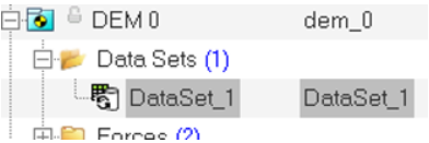

  7. Note: To change the IP address of the machine, the communication interval, or Start EDEM simulation at time after the system is created, use the data set 'DataSet_1' within the system.
    Figure 4. Data Set within the EDEM System

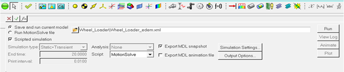

Once the model is defined, the solution process is identical to performing a “MotionSolve-only” simulation.
Use the Run panel in MotionView/MotionSolve to start the simulation. MotionView will launch MotionSolve.
MotionSolve will connect to EDEM (coupling server in EDEM should be ON) in the specified machine as a sub-process and start the communication. From here on, no additional user intervention is required to analyze the system.
Figure 5. The user-interface for running a MotionSolve + EDEM simulation

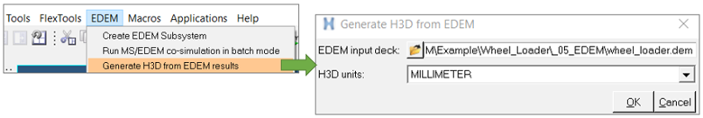

The EDEM results can be viewed in HyperView by translating it into the H3D format using the Generate H3D from EDEM results tool under the EDEM menu in MotionView.
Figure 6.
In the Generate H3D from EDEM dialog that appears, provide the EDEM model file (.dem) and specify the units to be converted into.
Note: Generating H3D from EDEM results is a computationally intensive process. A high performance computing (HPC) machine is recommended for very large size results.
