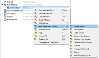

  5. In the Creator Tree, right-click on BulkMaterial 1 (which was just added) and select Add Shape from Library > Single Sphere.
    Figure 8. Add Single-Sphere Shape

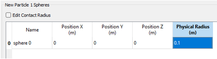

  6. Set the Physical Radius (m) to 0.1.
    Figure 9. Particle Sphere Properties

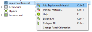

  8. In the Creator Tree, right-click on Equipment Material and select Add Equipment Material.
    Figure 10. Add Equipment Material
    A new material named 'EquipMaterial 1' is created.

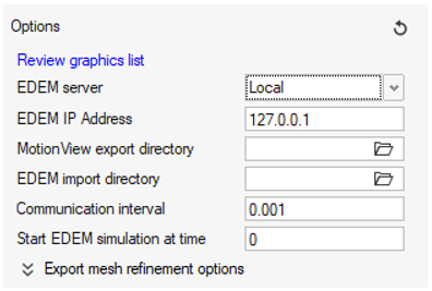

  14. In the panel that appears, click on to invoke the Options dialog and define the EDEM server.
    Figure 12. EDEM guide bar
    1. For EDEM server, choose between Local or Remote from the drop-down menu. Select Local if EDEM and MotionView/MotionSolve are on the same machine. Select Remote if EDEM resides on a different machine.
      Figure 13. Options Dialog
    2. If Remote has been selected, you will have to define the settings for the remote co-simulation, which are defined in the Bulk Material Interaction topic.
    3. Click on again to exit the Options dialog.

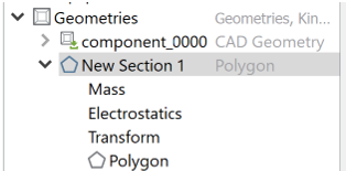

  19. In the Creator Tree, right-click on Geometries and select Add Geometry and then Polygon.
    A geometry with the name 'New Section 1' is added.
  20. Change the Type from Physical to Virtual.
    Figure 17. Polygon Geometry for the Particle Factory

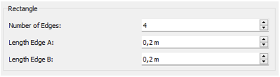

  22. Select Polygon under 'New Section 1' and set the following properties.
    Length
    Edge A 0.2
    Edge B 0.2
    Figure 18. Polygon properties

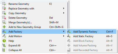

  23. Right-click on New Section 1 and select Add Factory > Add Dynamic Factory.
    Figure 19. Add Dynamic Factory
  24. Set the Target number (per second) equal to 5.

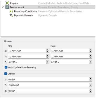

  27. In the Creator Tree, select Environment and Under Gravity set Y to -9.81 and Z to 0.
    Figure 22. Setting Gravity

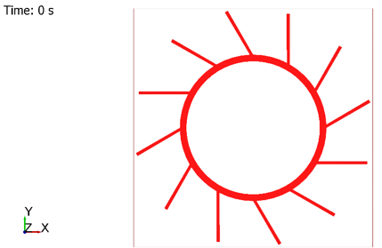

    MotionSolve is invoked and the simulation should also begin on EDEM side. The simulation process should also be visible in EDEM.
    Figure 26. EDEM Graphic Screen During Simulation

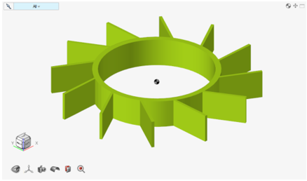

An equivalent flexible body H3D file of the wheel is available, flex_wheel_flex_blades.h3d (previously copied to your working directory).
Figure 32. Flexible Body
The flexible body is created with the following features:
  • The rotor elements are assigned the material property steel.
  • The blade element material has a material with 10% of Modulus of elasticity and density as steel.
  • The center node is connected to the nodes on the inner surface of the rotor using rigid (RBE2 elements).
  • The center node and a node on each blade (arbitrary) has been selected as interface nodes for an adequate modal representation.

  8. In EDEM, from the Creator context, reset the time to 0 s by clicking .
  9. Under Geometries, select the wheel geometry and delete it.
  10. Save the EDEM file as wheel_flex.dem.
  11. In MotionView, bring up the EDEM guide bar by clicking its icon from the Assembly ribbon.
  12. Change the collector to Body collector. Pick the wheel [Flex body].
  13. Click Transfer and Create System .
    The flex body should be transferred to EDEM. A new DEM system is also created in MotionView
