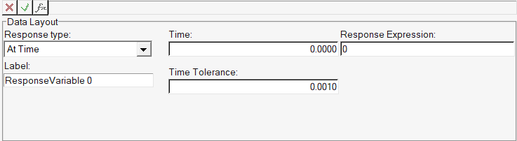

Modify a Response Variable
Once you add a Response Variable, by default, it is set to the type ‘At Time’. This will evaluate the value of the response expression at a specific value of simulation time.
To modify the RV Response type, use the drop-down menu and select one of the following:
