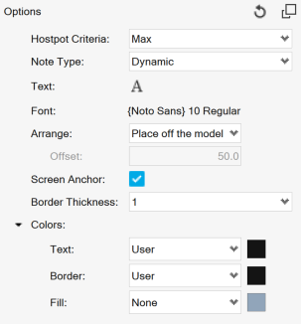

Set Preferences
Use the Options menu, located on the left of the guide bar, to specify some preferences upfront before running the tool.
  1. Open the Options menu by clicking on the guide bar.
    Figure 3.
  2. Reset the settings by clicking the Refresh icon .
  3. Set the Hotspot Criteria that the tool will run.
    Note: If Max and Min criterion is chosen, then two notes will be created, one showing the max value and entity ID and the other showing the min value and entity ID.
  4. The remaining options pertain to the note that will be displayed after the hotspot is found. You can specify the following:
    Note Type
    Static or Dynamic. Static will find and evaluate the templex at the current step and put the actual value in the note. The value will not change when the step changes. Dynamic, on the other hand, will evaluate the templex every time the step changes and update the value.
    Text
    By default, the Text is set to ID:{entity.id} Val:{entity.contour_max} OR {entity.contour_min} depending on Hotspot criteria, however you can add additional fields by clicking the A icon to display the Edit Text dialog.
    Note: This option is not available for Max and Min criterion, as it will just use the text to set the individual criteria.
    Font
    Set the desired Font type and size.
    Arrange
    Select the arrangement method for new notes.
    1. Place at entity will create the new notes at the location of their attached entity. It can also be manually dragged.
    2. Place off the model (default) will place the new note automatically outside the model in the modeling window, in the nearest location possible without overlapping the other notes.
    3. Explode off model center will place the new note automatically outside the model, in the direction from the center of the model to the location of the entity in a 2D projection plane.
    4. Explode with offset will place the new note in the direction from the center of the model to the location of the entity in a 2D projection plane, using the offset value specified under this field.
    Screen Anchor
    Select this option to anchor the note in the modeling window to stop it from moving during animation, zoom, pan, and rotation.
    Border Thickness
    Set the desired border thickness.
    Colors
    Set note colors upfront for new notes by selecting coloring modes for the note Text, Border, and Fill.
    1. Select the User color mode to set a color of your choice for the note Text, Border, or Fill. This is the default setting for note Text and Border.
    2. Select the Maintain Contrast note text color mode to make sure that the note text color always maintains contrast with respect to its fill color by using the text color black or white.
    3. Select the Component color mode for Text, Border, or Fill to set the respective color the same as the parent component color of the entity attached to the note.
    4. Select the Contour color mode for Text, Border, or Fill to set the respective color the same as the contour color assigned to the entity attached to the new note.
    5. Select the None color mode for Fill to maintain the note fill as transparent. This is the default setting for note Fill color.

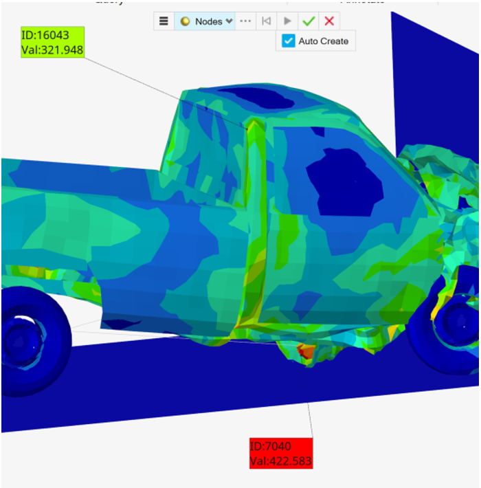

    Auto-Create mode
    This mode is for the primary use case, where you can drag a window around any region of your model and the tool instantly finds the hotspot entity and displays its ID and value in a note.
    Manual Create mode
    In this mode, the Advanced selection and Create buttons are activated. This allows you to first build a selection of entities through any one of the available selection methods (graphical picking, selecting by window, by set, by components and so on) and then upon clicking the Create button, a note is shown attached to the hotspot entity with its ID and value.
The image below shows the sample results of the Quick Hotspot Tool (Hotspot criteria = Max, Arrange option = Place off the Model and Fill color = Contour).
