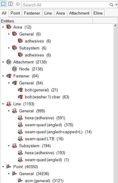

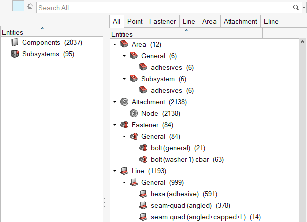

- The Link Entity Browser – located in the left pane of the split tab, it
displays information about all of the linked entities in the model and
Connectors groups.

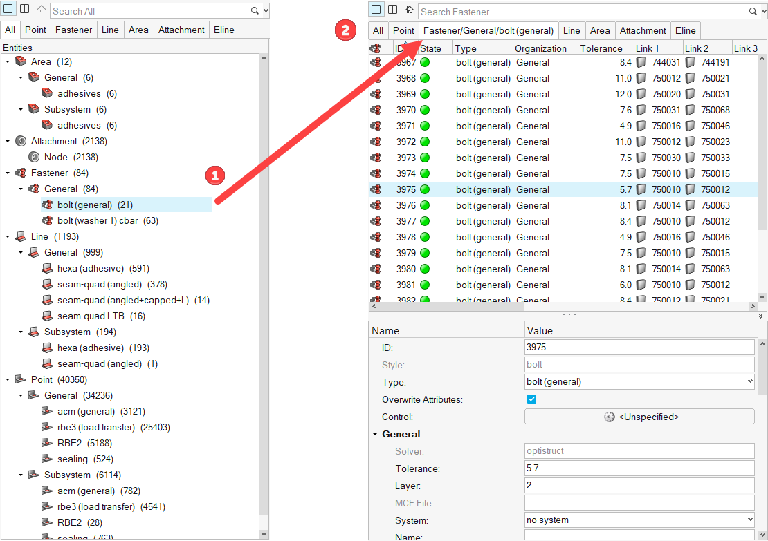

- The All Tab – displays a table of contents tree view of all the connections
the model contains. HyperMesh organizes
and displays the connectors in different folders based on their respective
realization type. The names of the folders are obtained from the FE
configuration names that are specified for respective solvers in the
feconfig.cfg file.

The actions performed in the Connector Browser, such as selecting, highlighting, showing, or hiding supported entities, are reflected in the modeling window.
The browser and the HyperMesh database synchronize with each other to ensure that all the changes made to the connector or the supported entities information in the database are reflected correctly in the browser at all times.
