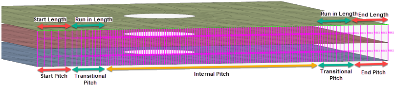

Pitch Options
Overview of the general pitch options.
Pitch Option
Pitch
Create a connector realization at regular intervals of a specified distance.
Density
Create a specified number of realizations that are equally distributed between the significant points. If the value is lower than the significant points, realizations are created at each of the significant points.
Distribution Option
Linear
The distribution of the significant points are linear (the distance between each significant point is constant).
Exponential Bias
The distribution of the significant points is set according to an exponent.
NL Biasing Value
Specifies where the transitional area is biased. For example, 10 indicates bias in the intermediate area, whereas 0.1 indicates bias in the start/end area.
Run In Length
The length of the transitional area between the Start/End Pitch and the Internal Pitch.
Start Length/End Length
Start Length and End Length are the lengths that the Start Pitch and End Pitch affect, respectively.
Start Pitch/End Pitch
Start Pitch and End Pitch are the pitch values of the Start Length and End Length, respectively.
Internal Pitch
The pitch value of the intermediate area (between the start and end lengths).
Single End
The End Length and End Pitch options are removed, and the Internal Pitch affects the whole of the remaining length.

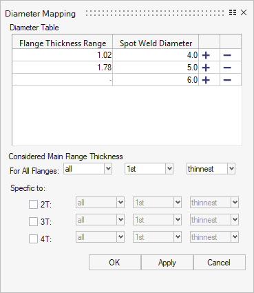

Diameter mapping file
Obtain diameter values that you assigned to a range of flange thicknesses in the Diameter Table.
Along with flange thickness ranges, you can also specify the main flange thicknesses to consider when assigning diameter values.

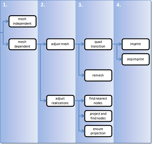

Figure 6. Outline of the Four-Stage Process Used to Select the Best Routine for Point and Line Realizations
Figure 7. Outline of the Three-Stage Process Used to Select the Best Routine for Area Realizations
Mesh Independent
The connector realizes independently from the mesh. Use for realizations which do not need any mesh changes, and the connection is primarily defined via a solver-specific card or the nodes which need to be connected are defined by a cylinder, such as Bolt (cylinder spring) for Radioss.
Position to Edge (Line Only)
Uses edge snapping and adjusts the realization to the edge of the link.
Offset from Edge (Line Only)
Allow a user-defined input to offset the realization from the edge.
Mesh Dependent (Point/Line/Area Options)
Adjust Realization
The realization is adjusted depending on the adjustment method defined below. The mesh is not modified, at the expense of non-normal or incomplete realizations. Many realization types are defined with head elements attached to body elements. In the case of these realization types, the head elements realize the connection without modifying the mesh, and the body elements are created in a normal direction.
Find nearest nodes
Searches for the nearest nodes within the given tolerance, making it possible to connect t-joints and similar areas. This option is especially useful in situations where the connectors are not positioned perfectly. These realizations are allowed to be non-normal.
Find nearest nodes does not do any projection.
Project and find nodes
Requires a valid projection onto the link entities in the first step. In the second step the nodes closest to the projection points are used for the connection. If a projection (connector tolerance) is not possible, the realization fails. Because a non-normal projection for lines is always allowed, the results are the same as the results for find nearest node.
Ensure projection
The minimum condition for the realization is a possible normal projection. The realization is performed in the direction from one projection point to the next. If the projection point is coincident with a shell node, they are equivalenced.
Note: Ensure projection can lead to incompletely defined connections from a solver perspective unless the connector positions are not aligned to the mesh. The advantage of this projection method is the exact determination of the projection points.
Adjust Mesh
The mesh is adjusted to the projections; there are a few different imprinting options. The realizations are identical between the mesh independent and mesh dependant adjust mesh options.
Remesh
Perform a remesh operation on the imprint. The imprint location can contain quads and trias.
Smooth (Only for Hilock)
Adjust the nodes to accommodate the projection.
Quad Transition
Creates perfectly shaped quad elements around the projection line. The quad size is determined by the average mesh size. From one projection point to the next, exactly one pair of elements is created. You can also use this option to create lines from quad elements and realize the connections to the links through perfectly modelled t-edges.
For line quad transitions, the automatic snapping and feature detection option, Allow Snapping, is activated. This prevents the creation of elements that are too small and ensures that the geometry is not modified too much.
Free edges and features with an angle greater than 25° are always considered. If smaller feature angles should be considered, decrease the value in the Feature Angle field under the Behavior heading. Feature angles smaller than 5° are not considered at all.
By default, snapping is allowed by one third of the quad pattern element size. In the case of a predefined quad pattern element size of 10.0, the outer nodes can snap to features in 3.3. The algorithm also tries to snap all three nodes of a quad pattern or none.
Imprint
When creating mesh-dependent realizations with quad transitions, the quad transition meshes can overlap and disturb each other if more than one set of connectors is created too close to each other. The imprint option reconciles such transitions with each other and modifies the underlying mesh to match the results to create a result that is seamless and properly meshed.
The option Resolve Conflicts is activated by default, enabling smaller imprint conflicts to be automatically resolved when connectors are realized. Overlapping elements are released, and a normal remesh of that area is performed if the overlapping area is smaller than half the regular quad transition element size.
The size of the imprint can be determined using the pitch size (use pitch size) or using the average size of the underlying mesh (use avg. mesh size). If you want to define a specific imprint size, select user input size.
Skip Imprint
Prevents the last step of quad transition from being performed. Instead, the component ^conn_imprint is created, which contains the element pattern. These elements can be modified and manually imprinted later using the Connector Imprint panel.
Skip imprint enables you to realize such mesh-dependent realizations in complex areas of the model where the automatic imprint fails because of issues such as conflicting lines.

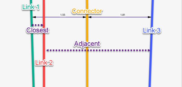

Link Option (Line/Area)
Closest
Uses the links closest to the connector by distance.
Adjacent
Uses the links adjacent to the connector.
Normal deviation
Deviation allowed for the projection.
Two links only
Selects only two links from the connector links.

Partial Imprint Percentage (Line Only, Mesh Dependent Quad Transition options)
Allow the imprint to not fully succeed along the connector and still mark the connector realized.
Imprint Options (Mesh Dependent Quad Transition options)
Preserve Washer
Controls how washers are preserved during the seam imprint realization.
No washer preservation
Washer layers are adjusted during the imprint if required.
Preserve washer, no remesh
The washer layers are fully preserved.
Preserve washer, allow remesh
The washer layers are still intact, but the mesh seeding has been modified.
Do Not Share Zone Elements (Line Only)
Seam imprint allows heat affected zones (HAZ) to be merged in close areas. In this situation, one element might touch the weld elements from two different connectors. Do not share zone elements prevents zone elements from being shared.
Quad In Corner (Line Only)
Double Quad corner/Single Quad corner
Controls whether a single or double element is created in corners of quad seam connectors with a certain vertex.
Corner Angle
An angle must be defined for a single quad corner. If the corner angle is greater than the defined angle, a double quad corner is created.
Quad Size Reduction %/ Quad Skew Degrees (Line Only)
Controls the maximum deviation from the perfect quad element for the heat affected zone (HAZ). It can be controlled, if the element size or the element skew is more important to retain.
Sliver Elements: (Line Only)
Sliver elements are small elements that you may not want in your model. In the images below, a perfect perpendicular projection resulted in sliver elements. The Sliver Elements setting can be used to manage sliver elements in your model. In the images below, the red elements represent the HAZ elements.
Allow
Allow sliver elements.
Prevent by moving projection points
Move the realization to the edge.
Prevent by moving edge
Move the edge to the realization.
Delete sliver elements
Keep the projection but remove the sliver elements.
Feature Angle
Determines important features to retain during the imprint. Features that cross the HAZ, as well as nearby features cannot be retained.
After Imprint
Remesh or rebuild the surrounding mesh after imprint for better mesh flow and quality .

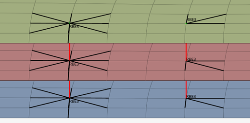

Rbe3 Radius
Every point realization that uses Rbe3 elements as the head, had the Rbe3 Radius option available, which can change the number of independent nodes.
Figure 9.
Options
Rbe3 Radius
Defines a circle with the specified diameter within which all nodes will be connected to the Rbe3 as independent nodes.
Rbe3 Radius Center
Specifies whether the center of each Rbe3 will be considered individually or the Rbe3 cluster center will be used (for Hexa (Rigid) only).
Feature Angle
Defines the angle at which nodes will stop being considered in the Rbe3.
Rbe3 Weight Factor
Specifies the weighing method for the Rbe3s.
Inverse distance
The distance from the center of the Rbe3 to a node, is inversely proportional to the weight that will be assigned to that node.
Normal distance
The distance from the center of the Rbe3 to a node, is proportional to the weight that will be assigned to that node.
Normalize Rbe3 Weights
Specifies if the weights of the Rbe3s will sum up to 1.
