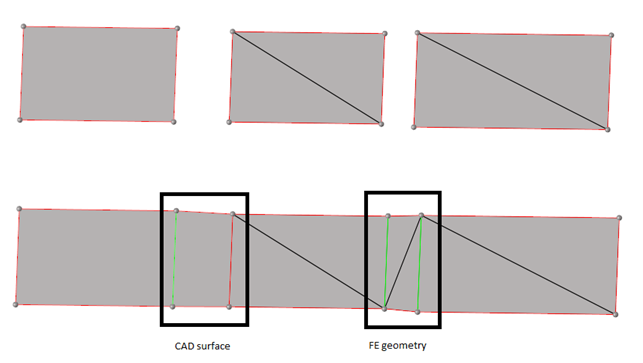

For FE geometry surfaces, the Patch tool creates FE geometry surfaces with tessellated elements. For CAD geometry, normal surfaces are created. If a patch is created between two different surfaces, then based on CAD or FE geometry, the below result is expected. A patch between CAD and FE geometry creates a CAD surface, while a patch between two FE geometry surfaces creates an FE geometry surface.
