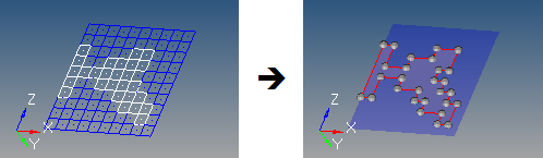

Create Surfaces from FE
Use the Surfaces: From FE tool to create surfaces that closely fit a selection of shell elements.
Figure 1. . In this example the mesh is changed from wireframe to transparent to make the surface more visible.
