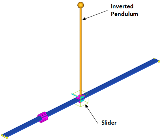

The image below shows the classic inverted pendulum on a slider. The system has two degrees of freedom leading to four state variables. The vertically upright position of the pendulum is unstable. The goal is to design a regulator to stabilize this configuration.
Figure 1. Inverted Pendulum Model
You want to find a full-state feedback control law to achieve the goal. The control input is a force applied to the slider along the global X-axis. Plant output is the pendulum angle of rotation about the global Y-axis.

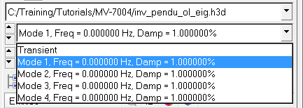

  9. From the Results Browser select individual modes.
  10. Click Start/Pause Animation to visualize the mode shape.

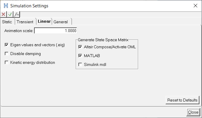

    Figure 3. Linear Tab in Simulation Settings Dialog for Specifying the MATLAB Matrix Files Output
  6. From the Simulation Settings dialog, click the Linear tab and select the MATLAB option under the Generate State Space Matrix section.
  7. From the Main tab, click Run.
    You should get six new files with base name inv_pendu_state_matrices and extensions .a, .b, .c, .d, .pi, and .po. The .pi and .po files contain information about the input and output variables.

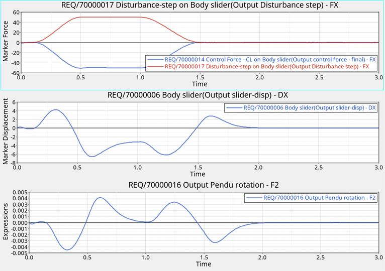

  8. Once the job is completed, close the solver window and plot the following results in a new HyperGraph page using inv_pendu_dyn.abf.
    Output Y-Type Y-Request Y-Component
    control force Marker Force REQ/70000014 Control Force - CL on Body slider(Output control force - final) FX
    disturbance force Marker Force REQ/70000017 Disturbance-step on Body slider(Output Disturbance step) FX
    slider displacement -X Marker Displacement REQ/70000006 Body slider(Output slider-disp) DX
    pendulum angular displacement Expressions REQ/70000016 Output Pendu rotation F2
    The plots of disturbance force, control force, slider x displacement, and pendulum angular displacement are shown below.
    Figure 4. Plots of Disturbance and Control Forces as well as Slider Translational and Pendulum Angular Displacements
