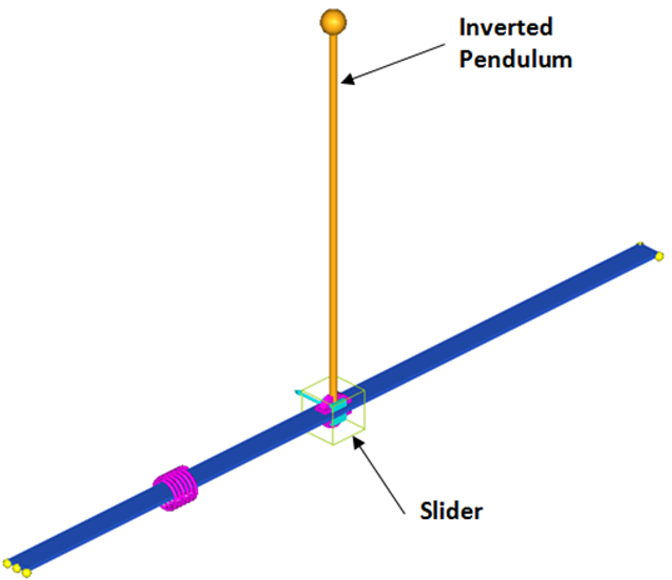

The image below shows the classic inverted pendulum on a slider. The system has two degrees of freedom leading to four state variables. The vertically upright position of the pendulum is unstable. The goal is to design a regulator to stabilize this configuration.
Figure 1. Inverted Pendulum Model
To achieve the goal, find a full-state feedback control law. The control input is a force applied to the slider along the global X-axis. Plant output is the pendulum angle of rotation about the global Y-axis.

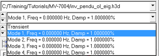

  8. Click Animate.
    The result animation H3D file is loaded in the adjacent window.
  9. From the Results Browser, select individual modes.
  10. Click Start/Pause Animation, , to visualize the mode shape.

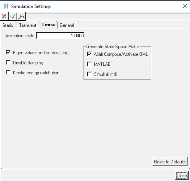

    Figure 3. Linear Tab in the Simulation Settings Dialog for Specifying the Compose Matrix Files Output
  7. From the Simulation Settings dialog > Linear tab > General State-Space Matrix, verify that the Altair Compose/Twin Activate OML check box is selected.
  8. From the Main tab, click Run.
    A new file is created with the base name inv_pendu_state_matrices.oml.

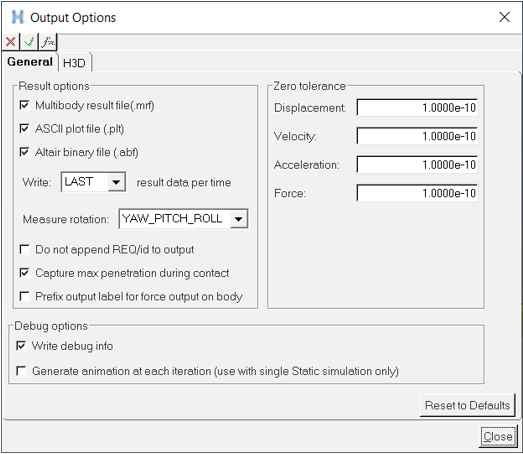

    Note: MotionSolve writes the selected states into the log file if Write debug info is selected under Output Options.
    Figure 4. General Tab in Output Options Dialog for Specifying the Write debug info.

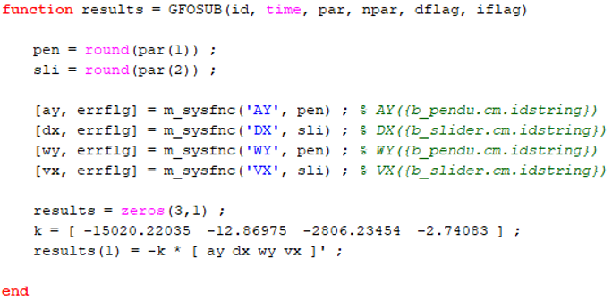

  2. Enter the following to define the function GFOSUB:
    function results = GFOSUB(id, time, par, npar, dflag, iflag)
    For more details on this subroutine, please see GFOSUB.
    par contains the IDs of the CM markers for the pendulum and the slider. IDs are defined later in via MotionView. For the sake of robustness, verify that the ID is an integer.
  3. On a new line, enter:
    pen = round(par(1)) ; sli = round(par(2)) ;
  4. Use m_sysfnc to save it as a variable. Enter the following:
    [ay, errflg] = m_sysfnc('AY', pen);
    [dx, errflg] = m_sysfnc('DX', sli);
    [wy, errflg] = m_sysfnc('WY', pen);
    [vx, errflg] = m_sysfnc('VX', sli);
  5. Write the control force for the inverse pendulum. It is the dot product between the gain vector (k) and the state vector (x) elements. Apply a GFOSUB on one body (Force_Vector_OneBody), and for that, the returned array needs to be of dimension 3.
    results = zeros(3,1) ;
    k = [ -15020.22035 -12.86975 -2806.23454 -2.74083 ] ;
    results(1) = -k * [ ay dx wy vx ]' ;
  6. Close the function with an end command.
    Below is an example of the complete function, with your script resembling the following example:
    Figure 5.
  7. Save this file to your <working directory> as GFOSUB.oml.

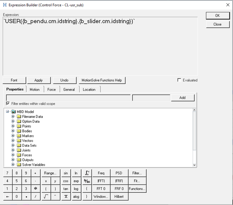

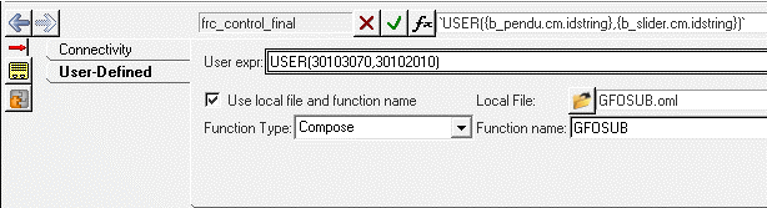

  2. From the Connectivity tab, select User-defined properties.
  3. From the User-Defined tab, edit the Force value with the Expression Builder to include the pendulum and slider marker idstring.
    Figure 6.
  4. Click OK.
  5. Select Use local file and function name, and select Compose from the Function Type drop-down menu.
  6. Use to select GFOSUB.oml from your <working directory>.
  7. Verify Function name is set to GFOSUB.
    Figure 7.

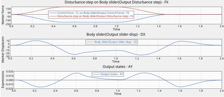

  8. Once the job is completed, close the solver window and plot the following results in a new HyperGraph page using inv_pendu_dyn.mrf.
    Output Y-Type Y-Request Y-Component
    control force Marker Force REQ/70000014 Control Force - CL on Body slider(Output control force - final) FX
    disturbance force Marker Force REQ/70000017 Disturbance-step on Body slider(Output Disturbance step) FX
    slider displacement -X Marker Displacement REQ/70000006 Body slider(Output slider-disp) DX
    pendulum angular displacement Expressions REQ/70000016 Output Pendu rotation F2
  9. The plots of disturbance force, control force, slider x displacement, and pendulum angular displacement are shown below.
    Figure 8. Plots of Disturbance and Control Forces as well as Slider Translational and Pendulum Angular Displacements
