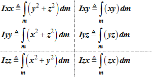

  7. The terms Ixx,Iyy, Izz , Ixy, Iyz, Izx are defined as follows:

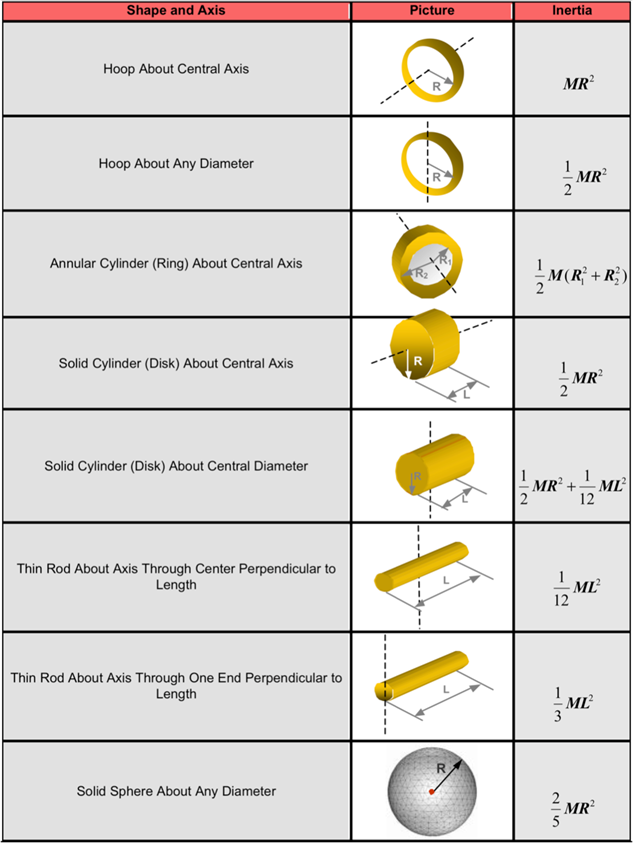

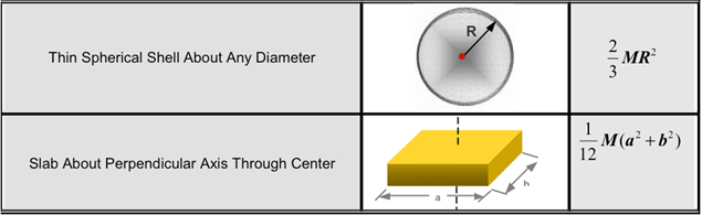

  17. The table below shows the moments of inertias of commonly occurring solid shapes.
