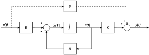

  2. The "LINEAR" version of a Control_StateEqn may be represented as a block diagram as shown in the image below.
    Figure 4. A Block Diagram Representation of Linear Control_StateEqn

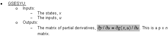

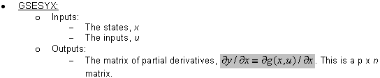

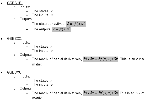

  4. The "USERSUB" version of a Control_StateEqn is more complex than most modeling elements that are defined via user defined subroutines.
    Five user subroutines may be needed. The first, GSESUB is required. The other four, GSEXX, GSEXU, GSEYX, GSEYU, are required only when a stiff integrator (VSTIFF or MSTIFF) is used.
    Figure 5.
    Figure 6.
    Figure 7.
