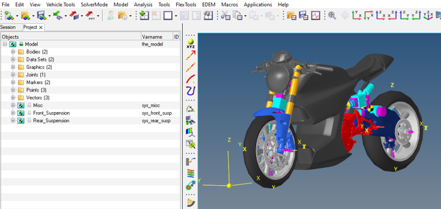

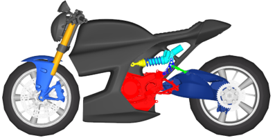

The motorcycle model available for this tutorial is a basic multibody model consisting of points, bodies, graphics, joints, spring dampers, and AutoTires (see Auto Tire - Auto Entity for additional information). No direct template or control-based systems are available inside the model to control the speed and lateral dynamics. The front and rear suspensions were tuned for stiffness, damping, and preload properties. The model, Motorcycle_Tutorial.mdl, reads the graphics information from the H3D file Motorcycle_Tutorial_graphic.h3d.
Figure 1. Tutorial motorcycle model

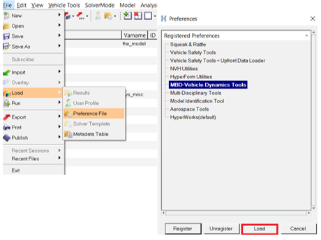

  1. In a MotionView session, on the menu bar, click File > Load > Preference File to open the Preferences dialog.
    1. Select MBD-Vehicle Dynamics Tools.
    2. Click Load.
  2. On the menu bar, click File > Open > Model and select Motorcycle_Tutorial.mdl to open the non-wizard motorcycle model.
    Figure 3. Motorcycle_Tutorial.mdl opened in MotionView

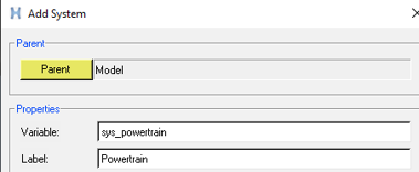

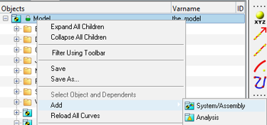

  3. Right-click on Model > Add > System/Assembly to create a Powertrain system.
    Figure 4.
  4. Enter sys_powertrain as the Variable name, and Powertrain as the Label.

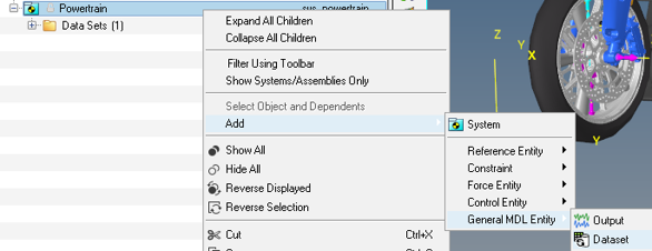

  5. Add a Dataset in the Powertrain system by right-clicking on Powertrain > Add > General MDL Entity > Dataset. Enter Powertrain Data as the name.
    Figure 6.

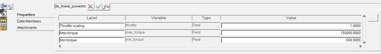

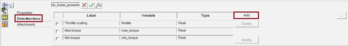

  6. In the created Dataset, under Data Members, create three data members of Type Real named:
    • Throttle scaling
    • Max torque
    • Min torque
    Figure 7.
  7. Under Properties, enter values for data members:
    • Throttle scaling = 1
    • Max torque = 150000
    • Min torque = -500
    Figure 8.

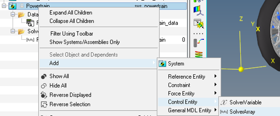

  8. Right-click on Powertrain > Add > Control Entity > SolverArray to create a solver array and label it as Powertrain.
    Figure 9.

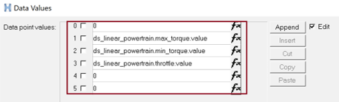

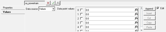

  9. In the created Powertrain solver array, under Values, select the Edit check box and Append 5 Data point values.
    Figure 10.

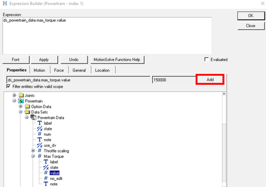

  10. Using the fx button, select the Max Torque dataset value and add it to the expression in the Data point value 1.
    Figure 11.
    Or enter ds_powertrain_data.max_torque.value in the array Data point value 1.
    Figure 12.
  11. Repeat the previous step adding the Min torque and Throttle Scaling values dataset in the arrays in the Data point values 2 and 3.
    Figure 13.
    Note: The zero value signals in the solver array are needed to maintain consistency with the IC Engine Friction Clutch Powertrain.

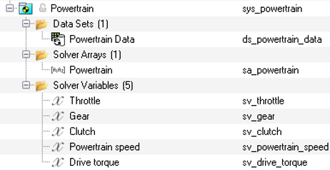

  12. Right-click on Powertrain > Add > Control Entity > Solver Variable to create 5 solver variables as follows:
    Label Variable
    Throttle sv_throttle
    Gear sv_gear
    Clutch sv_clutch
    Powertrain Speed sv_powertrain_speed
    Brake sv_brake
    Drive Torque sv_drive_torque
    Figure 14.

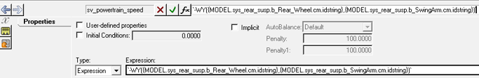

  13. In the Powertrain speed solver variable, modify the type to Expression under Properties and enter the expression:
    `-WY({MODEL.sys_rear_susp.b_Rear_Wheel.cm.idstring},{MODEL.sys_rear_susp.b_SwingArm.cm.idstring})`
    Figure 15.
    Note: This expression measures the angular speed of the rear wheels referred to the swing arm. The Altair Driver predicts the vehicle speed using the wheel angular speed and sets the required throttle to achieve the speed demand. If any gear ratio exists between wheel and powertrain, it needs to be multiplied with the wheel angular speed inside Powertrain solver variable expression.

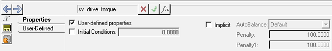

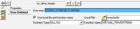

  14. In the Drive torque solver variable, select the User-defined properties option.
    Figure 16.
  15. 15. Under the User-defined tab, enter in the User expr:
    `USER(1,{sa_powertrain.idstring},{sv_throttle.idstring})`
  16. Select the Use local file and function name check box, enter msautoutils under Local File and VIRTUAL_POWERTRAIN under Function name.
    Figure 17.
    The solver signal specified by the user expression in the solver variable computes the Drive torque for the given throttle input from the Altair Driver. The drive torque solver variable reads the information from the Powertrain solver array data source 1 and the Driver throttle solver variable. For more information about the linear torque map powertrain see Linear Torque Map Powertrain.

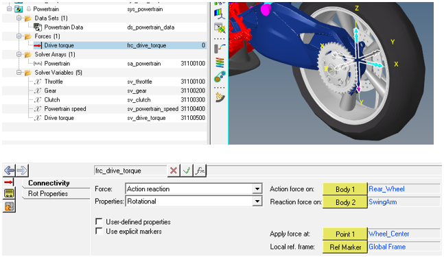

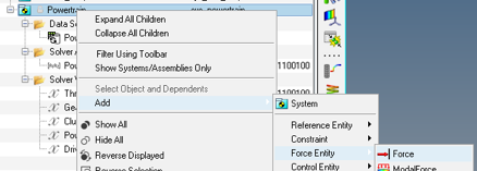

  17. Right-click on Powertrain > Add > Force Entity > Force to create a force entity to apply the drive torque in the rear wheel. Label the force Drive Torque.
    Figure 18.
  18. Under Connectivity, change the Force type to Action reaction and Properties to Rotational. Select Rear_Wheel as Body 1, SwingArm as Body 2, and Wheel_Center as Point 1.
    Figure 19.

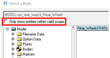

    Note: If the entities selection is not available, clear the option Only show entities within valid scope.
    Figure 20.

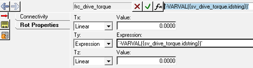

  19. In the Drive torque force entity, under Rot Properties, change Ty to expression and enter:
    `-VARVAL({sv_drive_torque.idstring})`
    Figure 21.

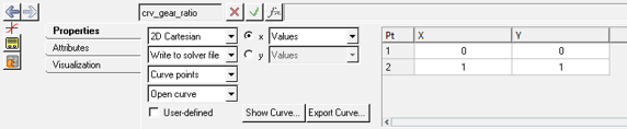

  20. Right-click on Powertrain > Add > Reference Entity > Curve to add a curve entity under the Powertrain system named Gear Ratio.
  21. Change the x and y type to values and enter (0,0) and (1,1) as shown below.
    Figure 22.
    This curve is required to maintain consistency with the IC Engine Friction Clutch Powertrain that models a manual transmission. The linear torque map engine used in this tutorial has only one gear ratio.
    Note: The Clutch and Gear solver variables are unused signals present to maintain consistency with the IC Engine Friction Clutch Powertrain and they are also needed to resolve the driver attachment.

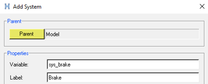

  1. Right-click on Model > Add > System/Assembly to create the Brake system.
    Figure 23.

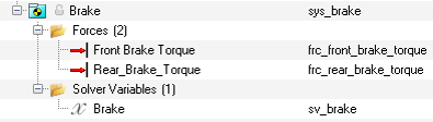

  2. Right-click on Brake > Add > Control Entity > Solver Variable to create the brake solver variable, Label it Brake.
    Figure 24.

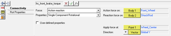

  3. Right-click on Brake > Add > Force Entity > Force to create 2 force entities to apply the brake torque in the front and rear wheel. Label them Front Brake Torque and Rear Brake Torque.
    Figure 25.
  4. Click on Front Brake Torque. Under Connectivity, change the Force to Action Reaction, and Properties to Single Component Rotational. Select the Front_Wheel for Body 1, ShockRod for Body 2, Wheel_Center of the front wheel for Point 1, change the Direction to Vector and select Global Y.
    Figure 26.
  5. Under Rot Properties, change T: to expression and enter: `VARVAL({sv_brake.idstring})*10000`.

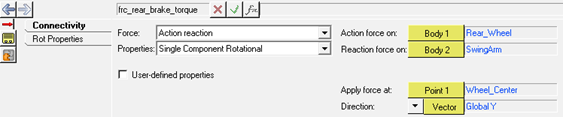

  6. Click on Rear Brake Torque. Under Connectivity, change the Force to Action Reaction, and Properties to Single Component Rotational. Select the Rear_Wheel for Body 1, SwingArm for Body 2, Wheel_Center of the rear wheel for Point 1, change the Direction to Vector and select Global Y.
    Figure 27.
  7. Under Rot Properties, change T: to Expression and enter: `VARVAL({sv_brake.idstring})*10000`.

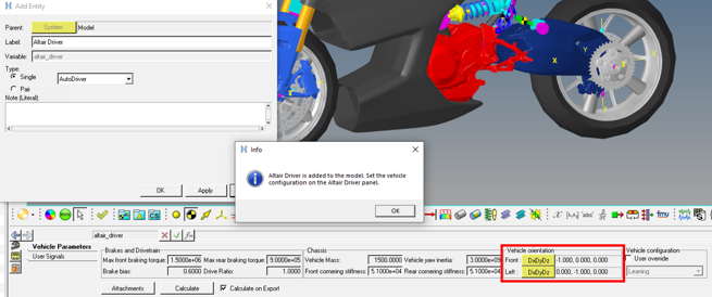

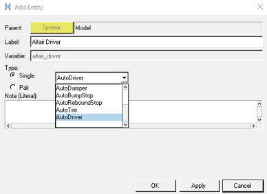

  1. Right-click on Model > Add Auto Entity. Select Altair Driver and click OK.
    Figure 29.
    Note: An Info dialog is shown asking to set the vehicle configuration on the Altair Driver panel. The vehicle configuration has the Front and Left vectors defined according to the orientation of the vehicle and is used as reference for the Altair Driver to control the vehicle. In case the vehicle model is created in a different coordinate system than Front: -X and Left: -Y, the Vehicle Orientation in the Altair Driver panel must be changed to the model’s reference.
    In cases where the vehicle has more than two wheels, but the vehicle body is expected to lean, the Vehicle Configuration can be modified to “Leaning” or “Non-leaning”. According to this selection, leaning or non-leaning events can be added in the model.
    Figure 30.

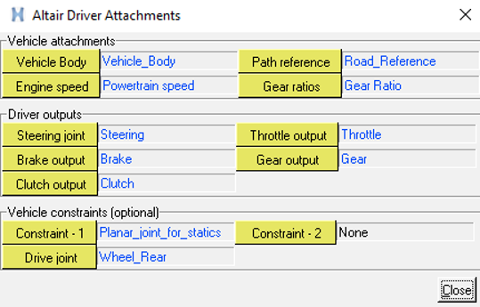

  2. In the Altair Driver panel, click on Attachments. Populate the attachment as follows:
    Vehicle Attachments Selection
    Vehicle Body (Body) Vehicle_Body Required for the Altair Driver to calculate the velocities, accelerations, and position of the vehicle.
    Engine Speed (Solver Variable) Powertrain speed Required to estimate the engine speed.
    Path Reference (Marker) Road_Reference Required to predict the path and to recognize the road surface, its origin and orientation.
    Gear Ratios (Curve) Gear Ratio Required gear ratios to multiply the drive torque. In this tutorial a dummy curve was created and is not used in the powertrain.
    Driver Outputs Selection
    Steering Joint (Joint) Steering Required joint for applying the steering control torque/motion from the Altair Driver in the model.
    Brake output (Solver Variable) Brake Receives the brake values from the Altair Driver to be applied in the Brake torque entity.
    Clutch output (Solver Variable) Clutch Receives the clutch configuration On/Off from the drive. For the linear powertrain, present in this tutorial, this is not used.
    Throttle output (Solver Variable) Throttle Receives the throttle output from the Altair Driver to be applied in the powertrain model based on the demand torque/vehicle speed.
    Gear output (Solver Variable) Gear Receives the gear position from the Altair Driver.
    Vehicle Constraints (optional) Selection
    Constraint – 1 (Joint) Planar_joint_for_statics Constrain the vehicle from yawing while solving the static simulation. After the static, this joint is deactivated.
    Drive Joint (Joint) Wheel_Rear Used to lock the rear wheel while solving the static simulation. After the static, this joint is deactivated.
    Note: These attachments are optional and can be left unresolved, however, to achieve a good static solution and equilibrium position, it is recommended that all attachments are resolved.

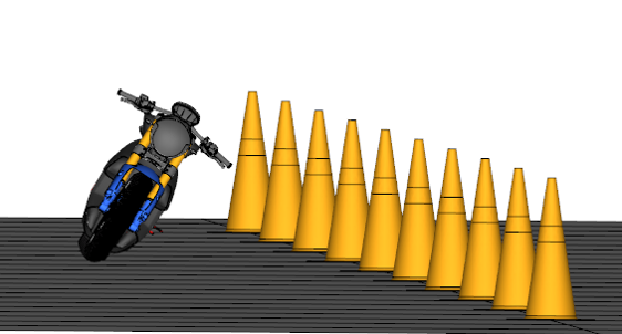

At this step any full vehicle events can be added in the model. In this tutorial a Slalom Event is included.

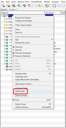

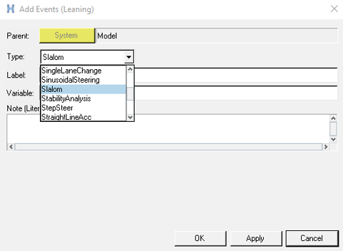

  1. Right-click on Model in the browser and select Add Events from the context menu.
    Figure 32.
  2. Select Slalom from the events list and click OK.
    Figure 33.

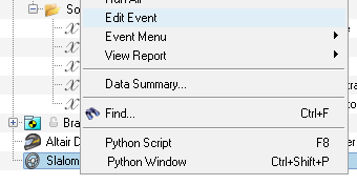

  3. Right-click on the Slalmom event and select Edit Event.
    Figure 34.

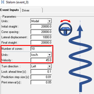

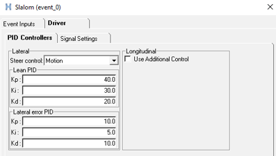

  4. In the Slalom event, change the number of cones to 10, modify the velocity units to km/h, and set 45km/h as the velocity.
    Figure 35.
    Under the Driver tab it is possible to select the steering control input between Motion and Torque, and modify the PID control gains.
    Figure 36.

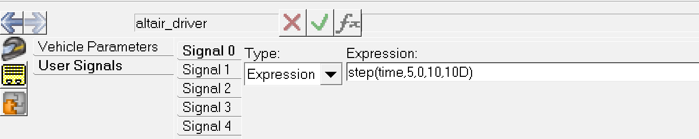

In this step the vehicle lean control is set from User Signals to replace the ADF Driver commands defined by a Step Steer Event.

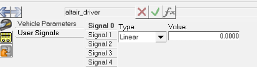

  1. Under the Altair Driver in the User Signals tab, select Signal 0, modify the Type to Expression, and enter: `Step(time,5,0,10,10D)`.
    Figure 39.

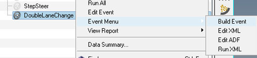

  2. Right-click on Model > Add Events. Select StepSteer, Label = StepSteer and Variable = event_stepsteer, and click OK.

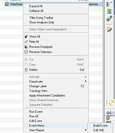

  3. Right-click on the StepSteer event, under Event Menu select Build Event.
    Figure 40.
    The Build Event will generate the necessary files to simulate the model.

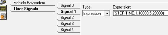

  1. Under the Altair Driver in the User Signals tab, select Signal 1, modify the Type to Expression and enter: `Step(time,1,10000,5,20000)`.
    Figure 44.
  2. Right-click on Model > Add Events. Select Double Lane Change, Label = DoubleLaneChange, and Variable = event_DLC, and click on OK.
  3. Right-click on the DoubleLaneChange event, under Event Menu select Build Event.
    Figure 45.

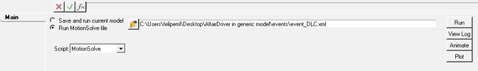

  5. Under Type enter ‘MOTIONVIEW’, replace the line VALUE = 1000 with SIGNAL_CHANNEL = 1.
    Figure 47.
  6. Save the event_DLC.adf file, in the MotionView Run panel, select Run MotionSolve file, locate the exported event_DLC.xml, and click Run.
    Figure 48.
