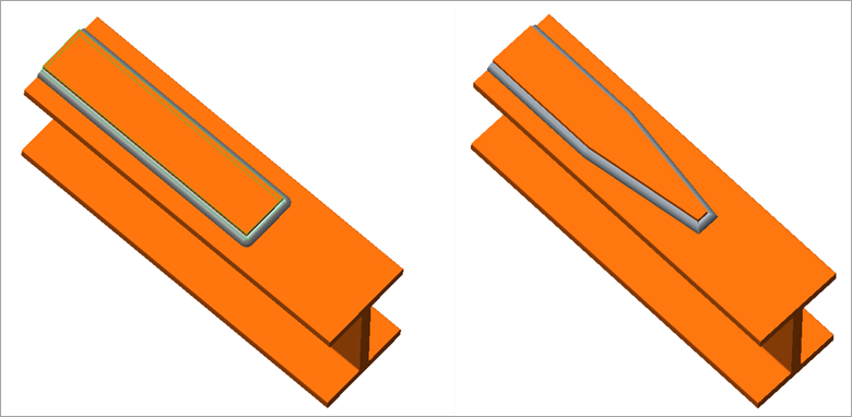

    First you need to consider a cover plate welded to a bending beam. A large stress concentration exists at the end of the cover plate because of the large change in stiffness. A better design is shown on the right side where there is a more gradual change in stiffness.
    Figure 3. (a) Incorrect Weld Design; (b) Correct Weld Design: Gradual Stiffness Gradient

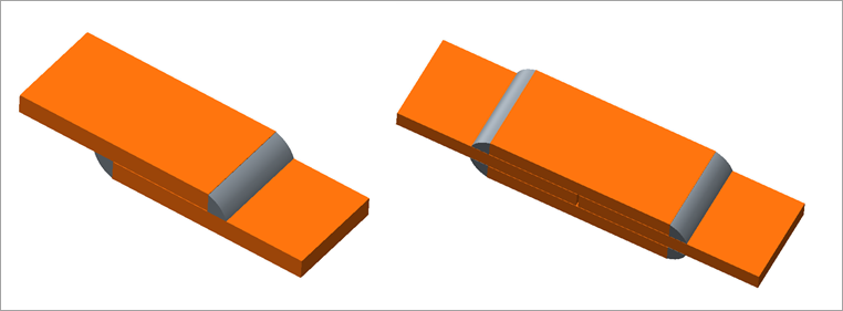

    A second source of stress concentration is unintentional bending stresses caused by asymmetric geometries. The design on the left will have larger bending stresses than the double lap joint on the right side.
    Figure 4. (a) Incorrect Weld Design; (b) Correct Weld Design: Double Lap Joint Symmetric Geometry

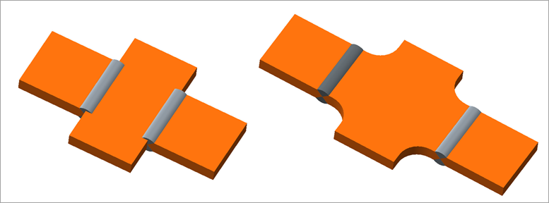

    Welding plates of differing thicknesses or widths is always problematic. Just as above, the easiest geometry to weld has the largest stress concentration. You should always consider moving the welds to lower stress areas in the structure and have a gradual transition in stiffness such as the joint shown Figure 5(b).
    Figure 5. (a) Incorrect Weld Design; (b) Correct Weld Design: Gradual Stiffness Transition

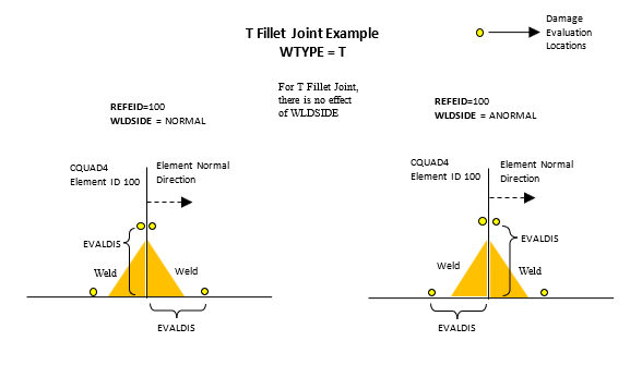

T-joint
  • One-sided One Row
    For a One-sided One Row T-joint, the weld element normal direction should point towards the weld toe. The nodes of the weld element are in line with the weld toes. The length should be determined by the actual dimensions of the weld element (typically L=T1+T2).
    Figure 7. Representation of a One-sided T-Joint Fillet Weld with One Row of CQUAD4 Elements
    The thickness of the weld element is the effective weld throat (typically it is equal to L/1.414).

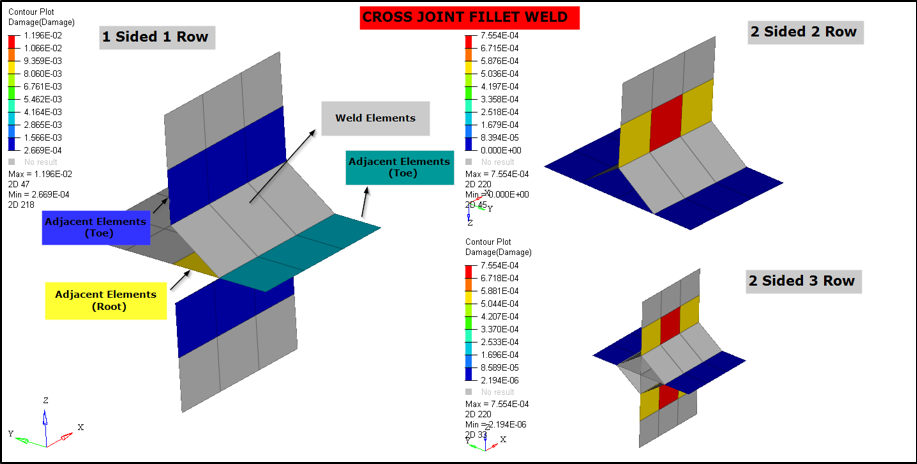

Cross-joint
For a cross-joint, all weld elements associated with one cross joint weld should be specified in a single FATSEAM entry, otherwise OptiStruct will treat the cross-joint fillet weld as separate multiple welds and may output unexpected results. Additional requirement for a cross-joint is that the joint should be symmetric.
  • One-sided One Row
    For a One-sided One Row Cross-joint, the weld element normal direction should point towards the corresponding weld toe.
    Figure 11. Representation of a One-sided Cross-Joint Fillet Weld with One Row of CQUAD4 Elements Each
  • One-sided Two Row
    Multiple rows are recommended for welds where the weld penetration is high and the weld typically forms the basis for contact between the two plates. Such welds are more rigid compared to welds where the penetration is lower, thereby additional rows of weld shell elements are required to capture the behavior. In Figure 12, the welds have penetrated more than the welds in Figure 11. For a One-sided Two Row Cross-joint, the weld element normal direction should point towards the corresponding weld toe. The vertical weld element normals should also point towards the corresponding weld toe.
    Figure 12. Representation of a One-sided Cross-Joint Fillet Weld with Two rows of CQUAD4 Elements Each
  • Two-sided Two Row
    For a Two-sided Two Row Cross-Joint, the weld element normal direction should point towards the corresponding weld toe.
    Figure 13. Representation of a Two-sided Cross-Joint Fillet Weld with Two Rows of CQUAD4 Elements Each
  • Two-sided Three Row
    Multiple rows are recommended for welds where the weld penetration is high and the weld typically forms the basis for contact between the two plates. Such welds are more rigid compared to welds where the penetration is lower, thereby additional rows of weld shell elements are required to capture the behavior. In Figure 14, the welds have penetrated more than the welds in Figure 12.
    For a Two-sided Three Row Cross-Joint, the weld element normal direction should point towards the corresponding weld toe. The normals of the vertical weld elements can point towards either weld toe on each side.
    Figure 14. Representation of a Two-sided Cross-Joint Fillet Weld with Three Rows of CQUAD4 Elements Each

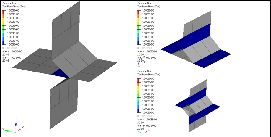

Fillet
The weld toe and root locations are evaluated. Throat location is not evaluated.
Note: The arrows in Figure 21 and Figure 22 indicate surfaces for evaluation (surface of the shell elements adjacent to the weld element).
Figure 21. Failure Locations for One Row Fillet
Figure 22. Failure Locations for Two Row Fillet

Supported Weld Types
OptiStruct supports certain types of welds for Seam Weld Fatigue Analysis using the Joint Line method.
The type can be selected using the WTYPE field on the FATSEAM Bulk Data Entry.
  • The Weld elements should not be modeled when using the Joint Line method
  • All elements sharing the same weld line and REFEID should have consistent element normals which match with the element normal identified by the corresponding REFEID element
  • The damage calculation locations only consist of the toes of the welds and they are based on the evaluation distance (EVALDIS field on PFATSMW entry) as explained below.
  • Refer to PFATSMW entry for more information on EVALDIS calculation
