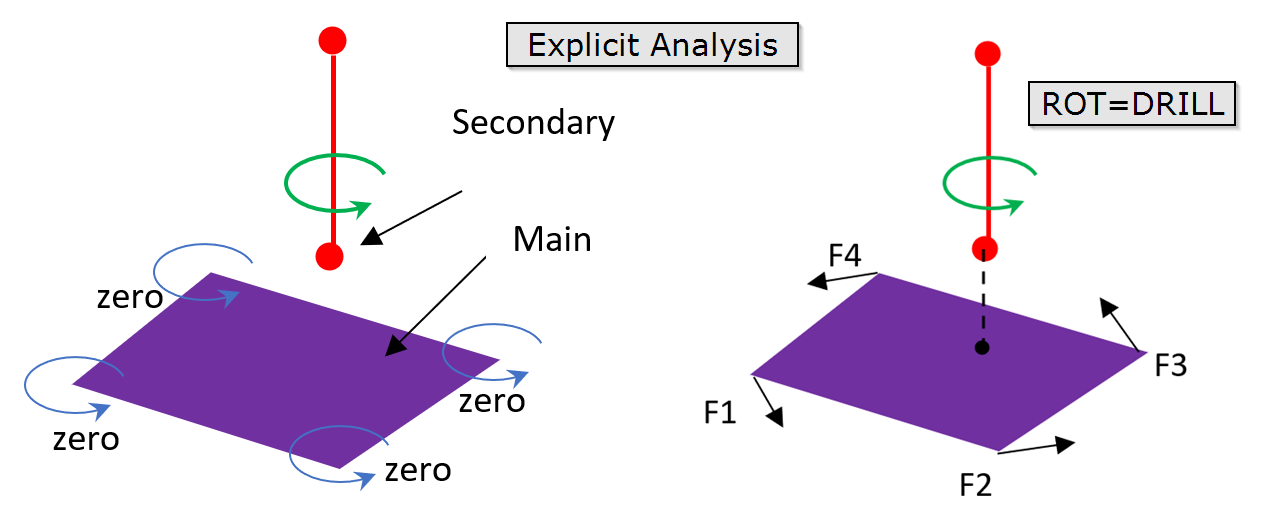

ROT Constraining rotational degrees of freedom for N2S and S2S FREEZE contact. 23
This option is ignored for N2S FREEZE contact with a CGAPG core.
YES
Rotational degrees of freedom are constrained.
NO
Rotational degrees of freedom are not constrained.
DRILL
Rotational DOFs are constrained and moments on secondary nodes are transferred to the main side as force if the main side is shell (for explicit analysis only).

  23. The ROT option is supported for both Implicit and Explicit analysis. For explicit analysis where the main side is shell, if the DRILL option is specified for ROT field of TIE and freeze CONTACT entries, the moment on the secondary side will be transferred to the main nodes as forces (instead of moments) as shown below. For explicit analysis with main side as solids, this is active by default and the ROT field has no effect.
    The following table shows support information for N2S TIE or N2S FREEZE contact (except for N2S TIE/FREEZE contact with a CGAPG core).
    N2S TIE/FREEZE Contact Linear Static/Transient/Modal Nonlinear Static Nonlinear Transient
    SMDISP/LGDISP Implicit (SMDISP/LGDISP) Explicit
    Rotational DOF (Main side is shell) ROT = YES (Default)/NO ROT = YES (Default)/NO ROT = YES (Default)/NO ROT = YES (Default)/NO/DRILL
    Rotational DOF (Main side is solid) ROT = YES (Default)/NO ROT = YES (Default)/NO ROT = YES (Default)/NO ROT = DRILL is always active and other options are not supported.
