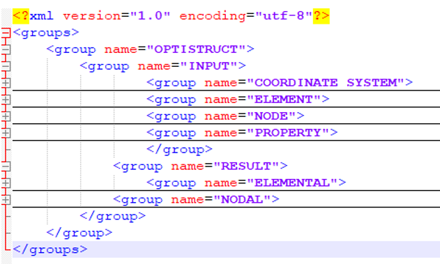

Supported Group Names
The data in an HDF5 file is hierarchically structured in the form of groups. The most basic form of data in the tree is called a dataset. The following tables summarize the currently supported groups and their relevant datasets.
OptiStruct INPUT Group
