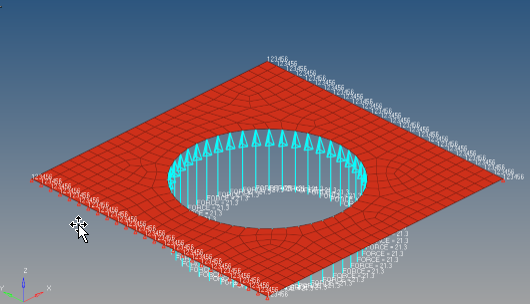

Figure 1 illustrates symbolic substitution of shell thickness of a thin plate with a hole when subjected to static forces.
Figure 1. Example Model: Thin Square Plate with a Hole
Boundary Condition and Loading
The sides AB and CD are fixed using SPC constraints and a total concentrated z-direction force of 1000 N are created on the nodes around the hole. The plate is defined as PSHELL with 10 mm thickness and steel as the material property with Young’s modulus of 0.21 MPa and Poisson’s ratio of 0.3.
