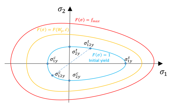

Tsai-Wu Yield Criteria for Iform=0 and =1
The Tsai-Wu yield surface in LAW25 is defined with 6 coefficient:
Iform=0: Tsai-Wu ( F ( σ ) ≤ F ( W p * , ε ˙ ) )

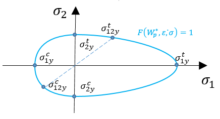

Iform=1: CRASURV ( F ( W p * , ε ˙ , σ ) ≤ 1 )
F ( σ ) = F 1 σ 1 + F 2 σ 2 + F 11 σ 1 2 + F 22 σ 2 2 + F 44 σ 12 2 + 2 F 12 σ 1 σ 2
F ( W p * , ε ˙ , σ ) = F 1 ( W p * , ε ˙ ) σ 1 + F 2 ( W p * , ε ˙ ) σ 2 + F 11 ( W p * , ε ˙ ) σ 1 2 + F 22 ( W p * , ε ˙ ) σ 2 2 + F 44 ( W p * , ε ˙ ) σ 12 2 + 2 F 12 ( W p * , ε ˙ ) σ 1 σ 2
To check if material in yield, in Tsai-Wu (Iform=0) F ( σ ) will be compared with F ( W p * , ε ˙ ) at each stress state and in CRASURV (Iform=1) F ( W p * , ε ˙ ) will be simply compared with 1 at each stress state.

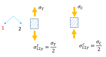

  • Shear tests
    Shear in plane 1-2
    Iform = 0: Tsai-Wu ( F ( σ ) ≤ F ( W p * , ε ˙ ) )
    Iform = 1: CRASURV ( F ( W p * , ε ˙ , σ ) ≤ 1 )
    F 44 = 1 σ 12 y c σ 12 y t
    σ 12 y t and σ 12 y c can result from the sample tests:
    F ( W p * , ε ˙ ) = ( 1 + b ( W p * ) n ) ⋅ ( 1 + c ln ( ε ˙ ε ˙ 0 ) )
    Here, W p * = W p W p r e f
    F 44 ( W p * , ε ˙ ) = 1 σ 12 y ( W p * , ε ˙ ) ⋅ σ 12 y ( W p * , ε ˙ )
    In shear:
    σ 12 y ( W p * ⋅ ε ˙ ) = σ 12 y ( 1 + b 12 ( W p * ) n 12 ) ( 1 + c 12 ln ( ε ˙ ε ˙ 0 ) )
    σ 12 y can result from the sample test:

The relative plastic work W p * is used in Tsai-Wu to calculate the yield surface; whereas in CRASURV, the relative plastic work is used to calculate the yield stress.
With F ( W p * , ε ˙ ) = ( 1 + b ( W p * ) n ) ∗ ( 1 + c ln ( ε ˙ ε ˙ 0 ) )
Here W p * = W p W p r e f
Material in elastic phase, if F ( σ ) ≤ F ( W p * , ε ˙ )
Material in nonlinear phase, if F ( σ ) > F ( W p * , ε ˙ )
The yield stress limit F ( W p * , ε ˙ ) is in range of 1 and f max
Material in elastic phase, if F ( W p * , ε ˙ , σ ) ≤ 1
Material in nonlinear phase, if F ( W p * , ε ˙ , σ ) > 1
