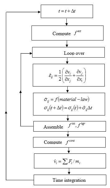

The Radioss numerical solver can be summarized by the flow chart in Figure 1. For each time step in a particular analysis, the algorithm used to compute results is:
  1. For the displacement, velocity and acceleration at a particular time step, the external force vector is constructed and applied.
  2. A loop over element is performed, in which the internal and hourglass forces are computed, along with the size of the next time step. The procedure for this loop is:
    1. The Jacobian matrix is used to relate displacements in the intrinsic coordinates system to the physical space:
      Φ x j | t = F ξ 1 Φ ξ | t
    2. The strain rate is calculated:
      ε ˙ i j = ( Φ I x j ) x ˙ = 1 2 ( v i x j + v j x i )
    3. The stress rate is calculated:
      σ ˙ i j = f ( ε ˙ , m a t e r i a l l a w )
    4. Cauchy stresses are computed using explicit time integration:
      σ ( t + Δ t ) = σ ( t ) + σ ˙ Δ t
    5. The internal and hourglass force vectors are computed.
    6. The next time step size is computed, using element or nodal time step methods (Dynamic Analysis)
  3. After the internal and hourglass forces are calculated for each element, the algorithm proceeds by computing the contact forces between any interfaces.
  4. With all forces known, the new accelerations are calculated using the mass matrix and the external and internal force vectors:
    v ˙ i = M 1 ( f e x t i f int i )
  5. Finally, time integration of velocity and displacement is performed using the new value.
    Figure 1. Numerical Procedure
