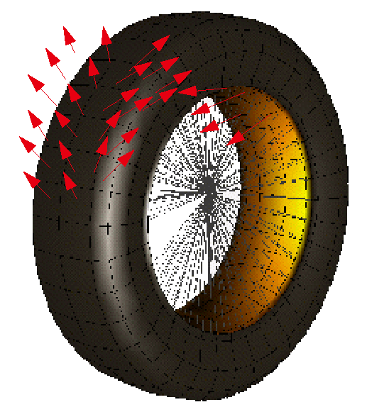

An airbag is defined as a monitored volume. A monitored volume is defined as having one or more 3 or 4 node shell property sets.
The defined surface must be closed (the normal to shell elements must be all oriented outward, as shown in Figure 1. The shell normal must be oriented outside the volume. It is possible to reverse the shell normals for a given property set (by entering a negative property number). Dummy properties (/PROP/TYPE0) and materials (/MAT/TYPE0) can be used.
Figure 1. Tire Model: Volume Closed
