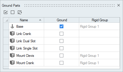

Ground Parts Table
The Ground Parts table lists all of the parts in your model and whether they are ground or not.
Location: Ground tool, satellite icon
Figure 1. Ground Parts Table
Table 1.
To Do this
Rename the part Select the cell in the table and then click again to make the field editable.
Change the ground state Select or deselect the check box next to the part.
Sort the column Click the column header. Click repeatedly to toggle between ascending and descending order.
Add or remove columns Right-click on a column header to change what result types are shown, and to sort the order of the columns.
