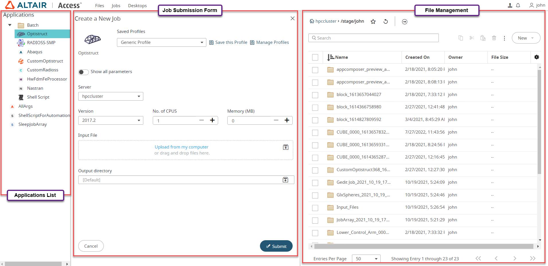

The Job Submission Form provides the following panes:
  • Applications List
  • Job Submission Form
  • File Management
Figure 1. Job Submission Form Page
Applications List
Applications (solvers) are displayed on the left-hand side of the Job Submission Form and are the applications that are installed on the HPC complex (server) selected in the Job Submission Form. Applications are categorized per your site's administrator.
The user defined application definition will also listed in the applications list.
Job Submission Form
The Job Submission Form contains the unique parameters necessary to submit a job for the selected solver.
By default, only the required parameters are displayed. Move the toggle switch to the right or click Show all parameters next to the toggle switch to display all available application parameters.
Note: The Server parameter will be displayed only if more than one Server Cluster is registered.
Tooltip displays the description of the application arguments when you mouseover the argument field.

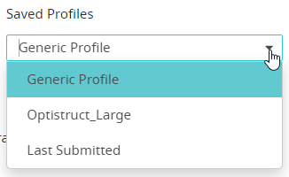

Profiles are displayed in a drop-down list just below the Saved Profiles.
Figure 2. Saved Profiles List
Three types of profiles are available:
Generic Profile
Displays the default arguments for the selected application.
Last Submitted
A special profile created automatically for each solver application storing your last job submission inputs.
Custom Profile
A profile created by you to save the job arguments that you have pre-populated.
Click Save this Profile to create a customized profile with the pre-populated arguments.

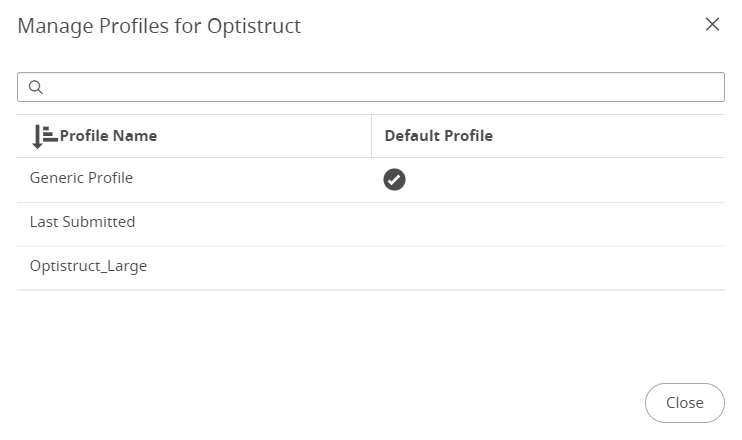

Click Manage Profiles to view the saved profile list. You can make a profile as default, rename, and delete the saved profiles from the list.

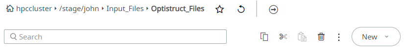

The File Management pane displayed on the right helps to manage and organize your job files. The File Management pane provides the following functionalities:
Figure 4. File Management Toolbar
  • Use the search box to narrow your search for the required directory or file.
  • Add a favorite for quick access to frequently used files and directories by clicking .
  • Quickly navigate to your home folder by clicking .
  • If you know the job input file folder path, then click and then type the folder path.
  • Specify job input files, include files and output directory using drag-n-drop or by right-clicking a file.
