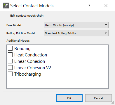

In the Select Contact Models dialog box, select the
following:
- Select the Base Model from the Base Model dropdown list.
- Select the Friction Model from the Friction Model
dropdown list.
- Select the Additional Model from the Additional
Models dropdown list.
Note: If Rolling Friction or Base model is not required, (for example if an API model has been used), select the No Base Model or No Rolling Friction Model.If an API model has been used, use the arrow icons to move the Contact Model up and down the list.
EDEM version 2020.1 and above allows you to select No Base Model and run the simulation from the command line.
- Optionally, select Edit Contact Chain to unselect Additional Models.

Click Preferences to configure the selected model.
EDEM is supplied with several integrated Contact models. You can also add custom plug-in Contact models, by selecting the checkboxes in the Edit contact models chain section. API models are displayed here if the custom model (
.dllor.sofile) is in the same location as the simulation.demfile or, if the folder is defined in . The first location of the.demfile is selected followed by the folder defined in the Tools menu.For more information about creating API models, see the EDEM Programming Guide.
