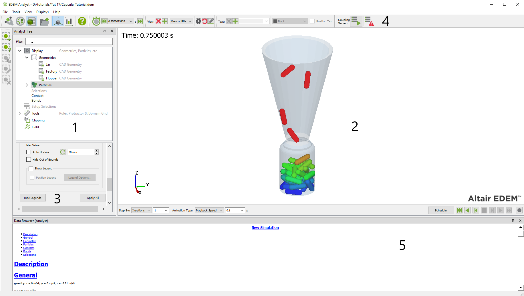

EDEM Analyst
EDEM Analyst is the post-processor used to analyze and visualize the results of your simulation.
- Configure and control the EDEM simulation engine
- Play back the simulation, graph results, save a still image, and create a video or export data
- The Analyst Tree
- The Viewer
- Section Details
- Analyst Toolbar and Menu Bar
- The Data Browser
The Analyst Tree
The Analyst Tree is displayed on the left side of the EDEM window and comprises five sections - Display, Setup Selections, Tools, Clipping, and Field. Right-click the Analyst Tree to expand/collapse all the corresponding subsections.
The Viewer
The Viewer displays 3D representations of your particles, Geometry, and fields (if applicable). The rotation, position, and zoom factor of the Viewer are controlled using the mouse. There are a number of animation controls displayed below the Viewer.
Section Details
The Section Details space contains all the information and configuration options for each section of the Analyst Tree. The options displayed within the Section Details correspond to the section or subsection being highlighted in the Analyst Tree.
The Tool Bar and Menu Bar

The Data Browser is a
.html page that displays detailed information about your model.
The information displayed differs between the Creator, Simulator, and Analyst.
Right-click the Data Browser and select Save to save the
information in an .html file.
