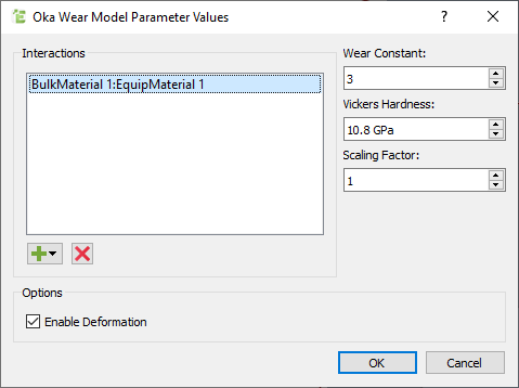

Interaction Configurable Parameters Position
Particle to Geometry Assign a wear constant, the Vickers Hardness value for each Equipment Material-Particle interaction and Scaling Factor (if Deformation enabled). Last
EDEM also provides the option to deform the Geometry according to the quantitative results given by the Impact Wear model.
In the Oka Wear Model Parameter values dialog box:
  1. Select the Enable Deformationcheck box to enable Geometry deformation.
  2. If you select Enable Deformation, you must specify the Scaling Factor which allows the deformation results to be scaled as desired.
