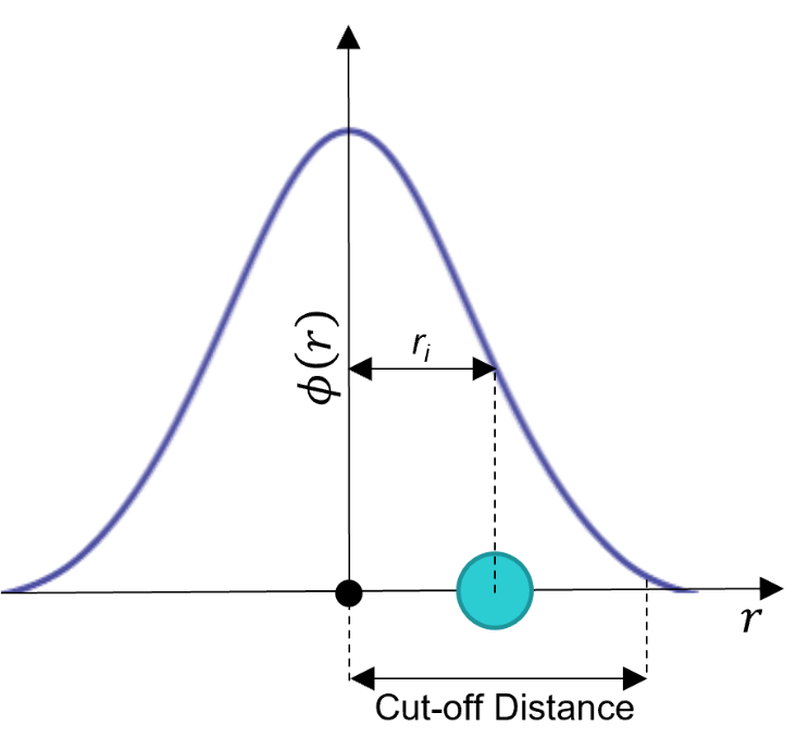

To calculate the Continuum values at each evaluation point, a distance weighted sum of the particle data is performed using the following Gaussian Weighting function where Φ(r) is the Gaussian Distribution function relative to the distance r, a given particle away from a given point.
ϕ = 1 ( ( c u t o f f 3 ) 2 π ) 3 2 e − r 2 ( c u t o f f 3 ) 2 MathType@MTEF@5@5@+= feaahyart1ev3aaatCvAUfeBSjuyZL2yd9gzLbvyNv2CaerbuLwBLn hiov2DGi1BTfMBaeXatLxBI9gBaerbd9wDYLwzYbItLDharqqtubsr 4rNCHbGeaGqiVu0Je9sqqrpepC0xbbL8F4rqqrFfpeea0xe9Lq=Jc9 vqaqpepm0xbba9pwe9Q8fs0=yqaqpepae9pg0FirpepeKkFr0xfr=x fr=xb9adbaqaaeGaciGaaiaabeqaamaabaabaaGcbaGaeqy1dyMaey ypa0ZaaSaaaeaacaaIXaaabaWaaOaaaeaacaGGOaGaaiikamaalaaa baGaam4yaiaadwhacaWG0bGaam4BaiaadAgacaWGMbaabaGaaG4maa aacaGGPaWaaWbaaSqabeaacaaIYaaaaOGaeqiWdaNaaiykamaaCaaa leqabaWaaSaaaeaacaaIZaaabaGaaGOmaaaaaaaabeaaaaGccaWGLb WaaWbaaSqabeaacqGHsisldaWcaaqaamaaemaabaGaamOCaaGaay5b SlaawIa7amaaCaaameqabaGaaGOmaaaaaSqaaiaacIcadaWcaaqaai aadogacaWG1bGaamiDaiaad+gacaWGMbGaamOzaaqaaiaaiodaaaGa aiykamaaCaaameqabaGaaGOmaaaaaaaaaaaa@5709@
The cut-off distance is used to determine the width of the distribution function. Using the above equation, 99% of the function's weighting is within a sphere of influence with a radius equal to the cut-off distance. Particles outside the sphere of influence of an evaluation point will not be included in the continuum calculation for that point. This is a parameter that you can change based on their particle data although a value of nine times the average particle diameters is typically recommended, especially if the particle size distribution is narrow.
