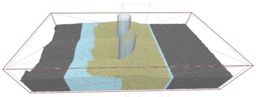

- While simulating, frozen particles are shown in blue/black, while
unfrozen particles are shown in yellow as follows:
The black coloring is shown only on the CUDA solver. It indicates that the particles are not only frozen but, have also been completely offloaded from the GPU (further increasing performance). The difference is only visible while simulating; it does not impact results.
