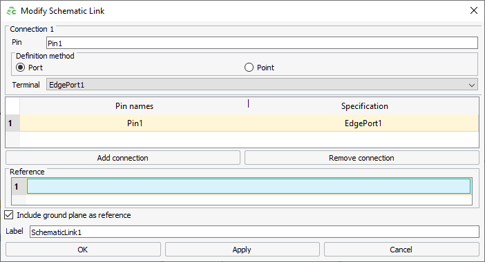

On the Cables tab, in the
Create Instance group, click the
Schematic link
icon.
- In the Pin name field, specify the name of the pin. This pin is the transitioning point from circuit elements (defined in the cable schematic view) to the full wave model.
Under Definition method, select one of the following
options for each connection:
- Port
- In the Terminal field, select a
defined port from the drop-down list or
create a new port. The positive port terminal is exposed on
the schematic as a circuit node. The negative port terminal
should coincide with the reference surface.Note: The defined port is limited to wire/edge ports.
- Point
- Under Point, specify the coordinates of the point that is exposed on the schematic as a circuit node.
Note: The physical connection is not indicated in the 3D view. -
[Optional] Under Reference, specify the face(s) defining
the common reference surface that translates to a single node of reference on
the cable schematic view.
Note:
- If one of the connections references a port, a reference face is required.
- If none of the connections references a port, a reference face is optional.
- Select the Include ground plane as reference check box to include a PEC infinite ground plane as part of the reference surface.
- In the Label field, add a unique label for the schematic link.
- Click Create to create the schematic link and to close the dialog.
