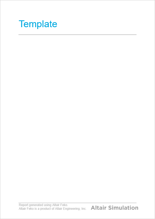

  1. Create a Microsoft Word (.dotx) template using one of the following workflows:
    • Use one of the predefined templates provided by Microsoft.
    • Create a template with the required styling.
    Figure 1. Example of a Microsoft Word template (.dotx file) with styling.

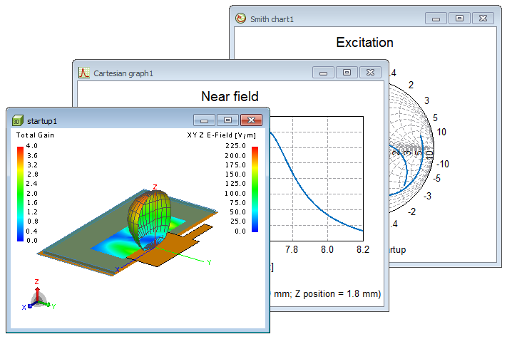

  2. In POSTFEKO, decide on the graphs and 3D views to be added to the report.
    For this example, the startup model is used. The required views are the 3D view and the graphs are:
    • startup1
    • Cartesian graph1
    • Smith chart1
    Figure 2. The startup model with the 3D view (startup1), Cartesian graph (Cartesian graph1) and Smith chart (Smith chart1) which will be required for the report.

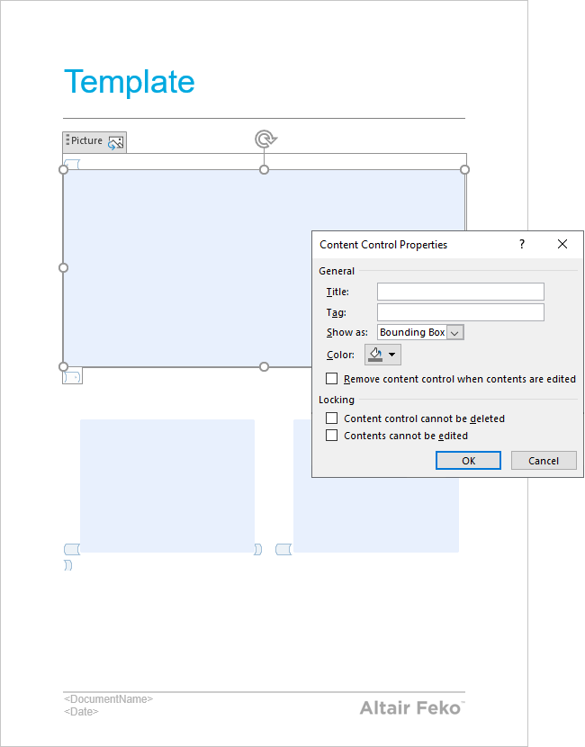

  4. Add content controls to the Microsoft Word template.
    1. In Microsoft Word, on the ribbon click the Developer tab.
    2. Add a Picture Content Control (Controls group) to the template at each location in the template where a graph or 3D view is to be added.
  5. Enable Design Mode in Microsoft Word.
    On the Developer tab, in the Controls group, click the Design Mode icon.
  6. Add tags to the Microsoft Word template.
    1. For each content control, on the Developer tab, in the Controls group, click Properties.
    2. On the Content Control Properties dialog, add the tag that links to a specific POSTFEKO graph.
      For this example, the tag is TagFor3dView.
    Figure 4. The Content Control Properties dialog in Microsoft Word where the tag for the POSTFEKO graph is specified.
