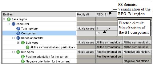

| 2 |
In the array*, fill out the zones for each region:
Note: * See figure below.
Array of coil conductors
The array corresponding to the regions of the coil conductor type (2D) is presented in the figure below.
In this array, the zones which allow the visualization of the regions (of coil conductor type) and of the electric components (of stranded coil conductor type) are showed in the figure below.
