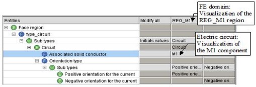

| 2 |
In the array*, fill out the zones for each region:
Note: * See figure below.
Array of solid conductors
The array corresponding to the regions of the solid conductor type (2D) is presented in the figure below.
In this array, the zones which allow the visualization of the regions (of solid conductor type) and of the electric components (of solid conductor type) are showed in the figure below.
