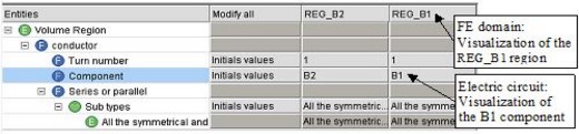

| 2 |
In the array *, fill out the zone for each region:
Array of coil conductors
The array corresponding to the regions of the coil conductor type is presented in the figure below.
In this array, the zones which allow the visualization of the regions (of coil conductor type) and of the electric components (of stranded coil conductor type) are showed in the figure below.

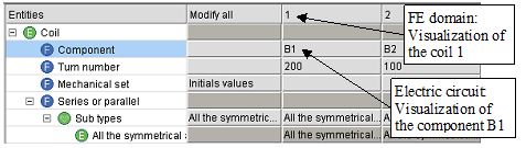

| 3 |
In the array * fill out the zone for every coil:
Array of non meshed coils
The array corresponding to the non-meshed coils is presented in the figure below.
