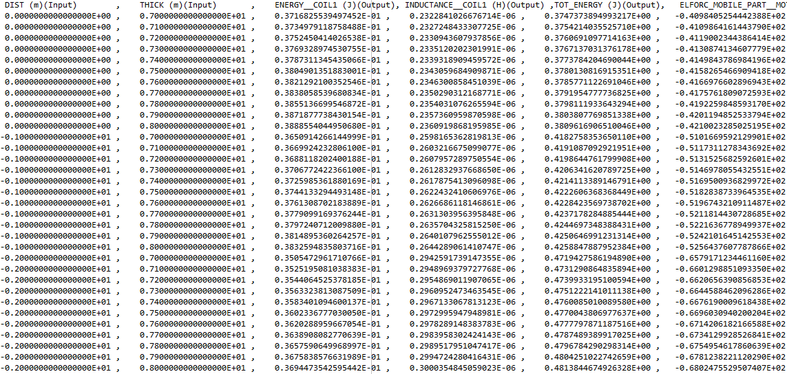

CSV file format
The first line contents:
- the name of quantities fr each column
- first parenthesis: the unity (if existing)
- second parenthesis: if it's an input or an output
The input parameters are set on the first columns and correspond to the parameters driven by the solved scenario.

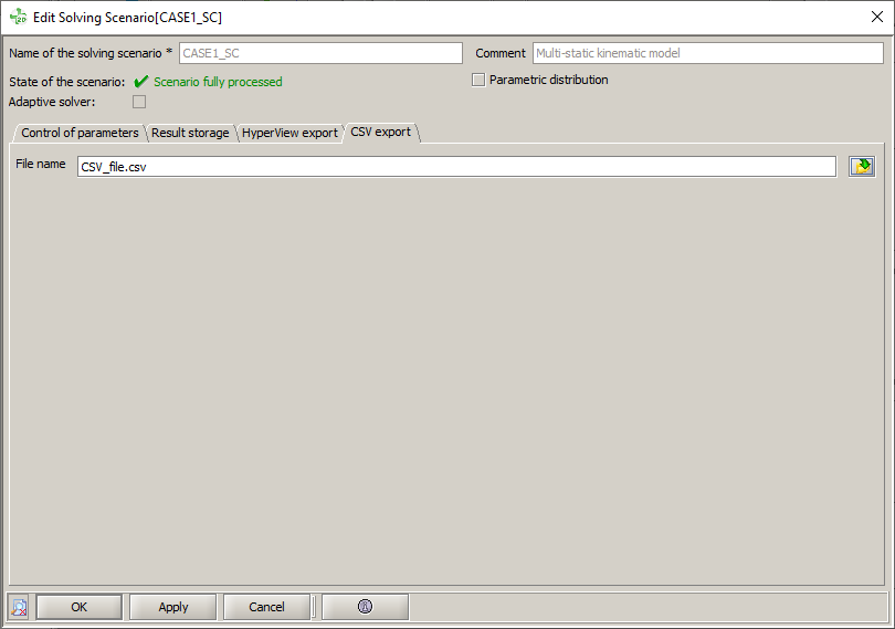

Export of the CSV file, in Flux
The export is accessible via the dialog box of the Solving scenario, in the tab CSV Export:
- Open / Create a solving scenario
- Define the parameters to be changed in the resolution (if not yet defined)
- Choose a name of the CSV file which should contain data
- Validate the solving scenario
- Launch the solving process
→ The CSV file is created and filled as the steps are solved
→ The CSV file can be consulted during resolution simply by opening it
