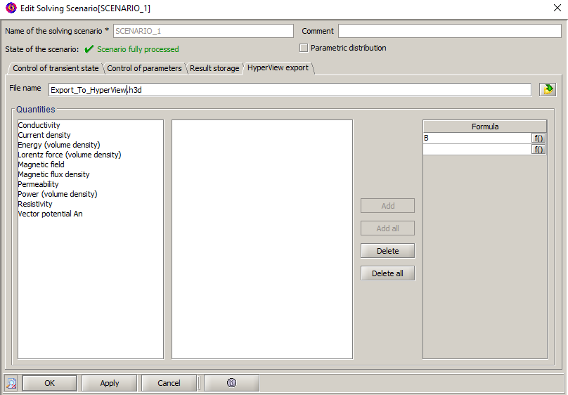

Export of .h3d file in Flux
Export function can be accessed via solving box, in HyperView
export tab:
The steps of the .h3d file export are described below:
- Chose a name for the .h3d file that will contain the data
- Chose the quantities to be computed on the device
Note: HyperView export can more or less decrease the speed of the solving process, depending on the project size.

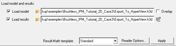

Import of .h3d file in HyperView
The .h3d file generated in Flux is imported in HyperView via menu: . Chose the file to import and click on
Apply.
Note: During
solving process, the results are not automatically updated in HyperView. In
order to update them, click again on the previous Apply
button.

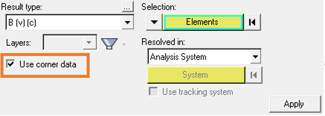

A few tips are presented below in order to view the results:
- In order to view the results computed by Flux on nodes, Use
corner data option must be checked:
