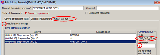

In the box of scenario, it is possible to choose the mode of storage:
- For all parametric application:
- ALL : Store all (by default)
- NOTHING : store nothing
- For transient applications:
- ALL : store all (by default)
- ONE OUT OFF : store 1 step on N
Partial storage in solving process
Before starting the resolution, the user has the possibility to choose the storage mode in the box of the scenario by ticking "partial storage of the results" in tab "Result storage"

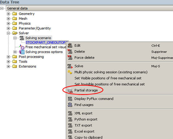

In the tree, at the node Scenario, a contextual menu "Partial Storage" allows opening the edit box of the scenario directly on the "Result storage" tab

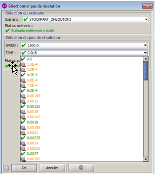

Step selector
Deleted steps exist with a status "solved and deleted by the user" and are displayed in orange contrary to the stored steps which are displayed in green.
Curve behavior
- For the electrical curves, all data are present
- For the curves of the spatial quantity computed after the steps are deleted
- If on two consecutive steps, no steps has been removed, then we connects the points linearly
- If on two consecutive steps, one step or more were removed, then we display cloud of points
