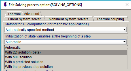

You can access this option in Beta (or advanced) mode, in the Solving process options. Under the Advanced tab, in “Initialization of state variables at the beginning of a step” field, select “With 2D solution (beta)”. Other solving options can be set as for a 2D solving.
