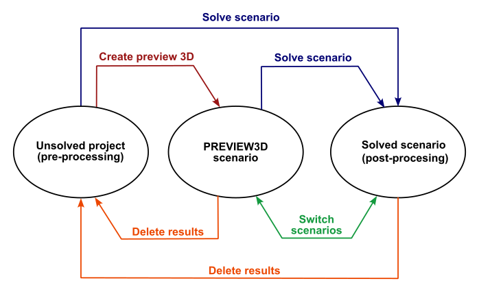

Transitioning between the pre-processing (2D view), preview 3D and post-processing contexts (Regular solved scenario) of a project in Flux Skew
Figure 1 below illustrates the different states of a Flux Skew project and the actions required to transit between them.
