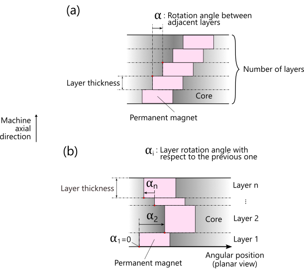

- Topology description: two approaches are available, namely the Simple (homogenous layers) method and the Advanced (layer by layer) method.
- The Simple (homogenous layers) description method is straightforward
and requires only three parameters (accordingly with part (a) of Figure 1):
- the Length unit allowing to choose the unit (or to create a new one) for the Layer thickness;
- the Layer thickness;
- the Rotation angle between adjacent layers, in degrees;
- the Number of layers, or the axial discretization of the
skewed machine after its 3D reconstruction (in post-processing).
Note: This parameter also corresponds to the total number of linked 2D finite element problems solved by Flux Skew along the axial length of the machine during resolution, as discussed in the topic: What is Flux Skew?
- The Advanced (layer by layer) method is also available and allows the
description of more complex topologies (V, W or zig-zag skewing, for
instance). In this approach, the user must fill a table in which each line
represents a skewed layer. Two parameters are required for each layer
(accordingly with part (b) of Figure 1):
- the Layer rotation angle with respect to the previous one, in degrees.
