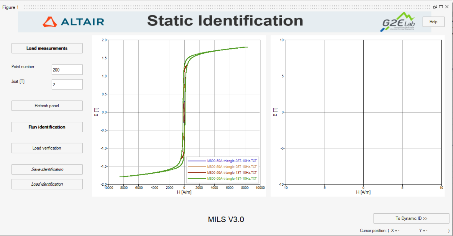

MILS's first panel is depicted in Figure 1. It provides the user with nine actions or steps to complete a static LS identification, as indicated by labels 1.1 to 1.9 in that figure. The mandatory steps are labeled in blue, while the optional actions are displayed in yellow.
Mandatory steps in static identification
A static identification consists of a five-step procedure in MILS. The mandatory steps are described below:
- Step 1.1: Click on button Load measurements, which is labeled as
1.1 in Figure 1. MILS
will ask for measurement files. The user must here provide a set of measurement
files representing a certain number of static hysteresis loops of the steel
sheet. Each file in the selected set should correspond to a hysteresis loop
reaching a different magnetic flux density (until saturation).Note: The static hysteresis loop measurement files are text files that follow a specific format. A detailed description of MILS's input formats is available here.Note: If the files are loaded correctly, MILS will display the measurements provided by the user in the Curves preview window, as shown in Figure 2.

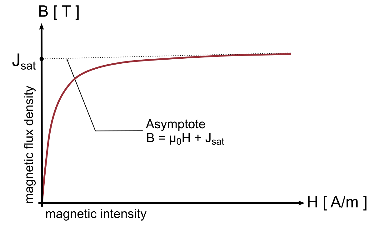

- Step 1.3: Provide an initial estimation for the value of
Jsat, the saturated magnetic polarization of the steel
sheet in the field labeled as 1.3 in Figure 1. Note: The Jsat parameter is measured in teslas and may be obtained from an anhysteretic magnetization curve of a steel sheet as shown in Figure 3. Remark that MILS re-evaluates Jsat during the static identification, representing a corrected value that fits the measurement set.

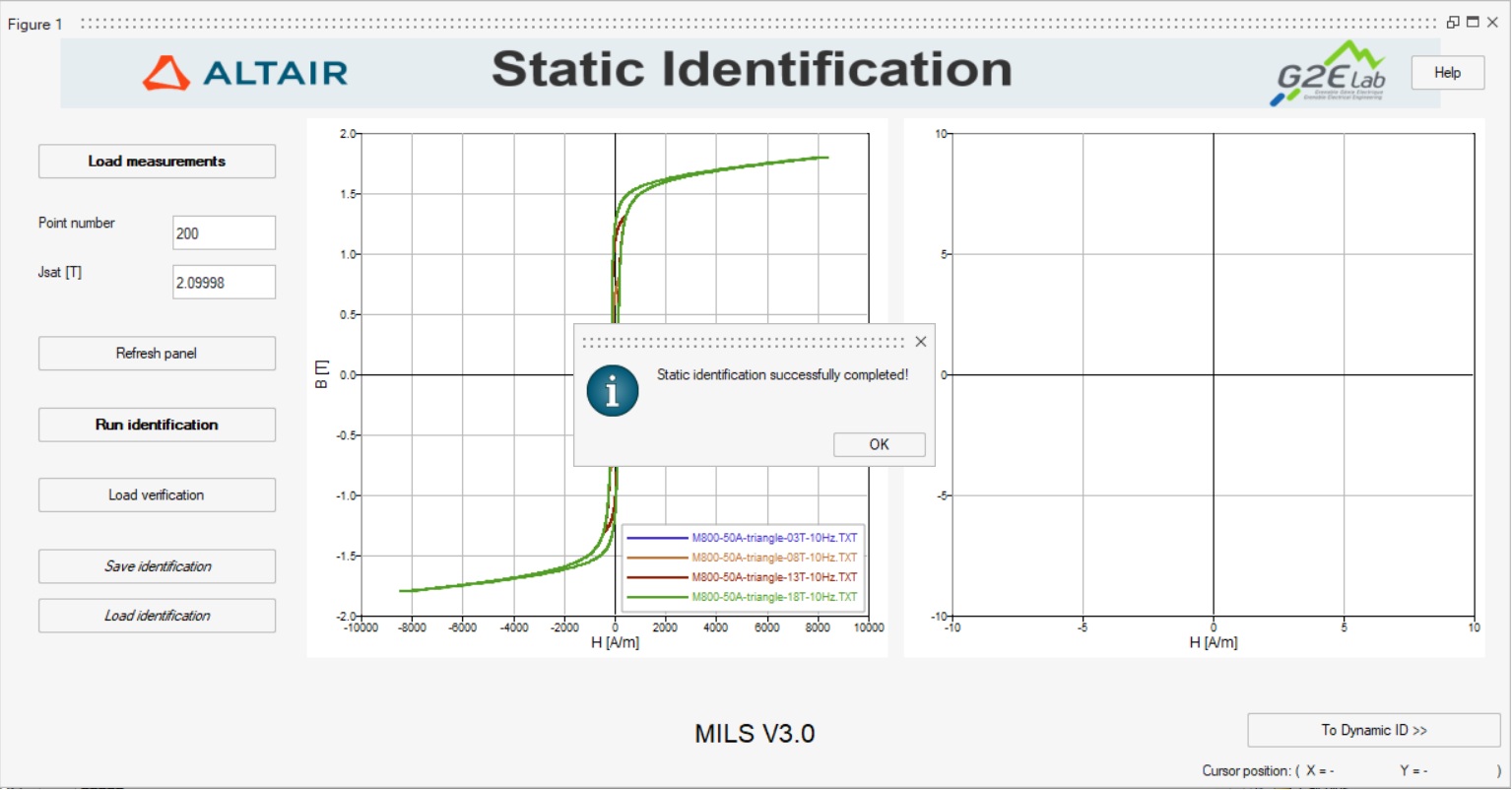

- Step 1.4: Launch the static identification by clicking on the Run
identification button, which is labeled as 1.4 in Figure 1.Note: The computation time required to complete the static identification is a function of the number of files loaded in step 1.1. Long identification times may be observed in the case of a large set of input files. A pop-up window appears at the end of the computation to announce the end of the static identification procedure, as shown in Figure 4.
Figure 4. The pop-up message announcing the end of a successful static identification.

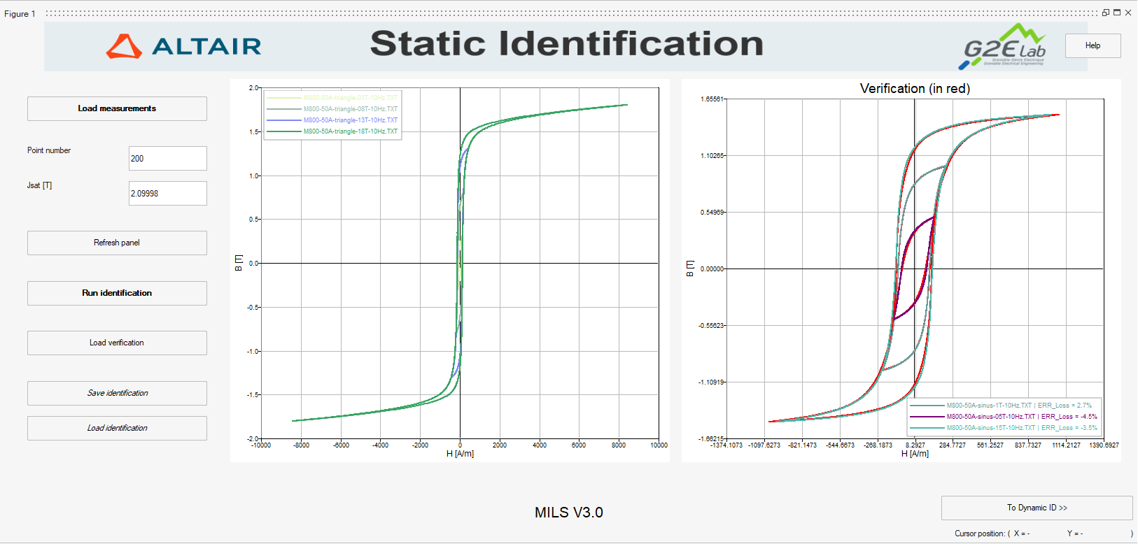

- Verification: After completion of the mandatory steps 1.1 to 1.4, an
optional verification of the static part of the LS model may be performed. This
verification consists of reconstructing one or more hysteresis loops (given as
an additional set of measurements) using the identified static LS model and by
comparing their associated magnetic losses. To do so, click on button Load
verification (labeled as 1.7 in Figure 1). This action
will open a dialog box asking for an additional set of measurement files. Note: In this verification step, the user may choose between loading the same measurement set used in step 1.1 or a different one. In any case, MILS uses the identified static model to reconstruct a hysteresis loop for each file, by admitting a B(t) input issued from the loaded file.Note: MILS plots the reconstructed hysteresis loops yielded by the static LS identification in red in the Verification window of the static identification panel. The measurements loaded for verification are also plotted for comparison.Note: MILS estimates the error in the evaluation of the static component of the iron losses by comparing areas of the hysteresis loops. The percent error between the identified model and a measurement file is displayed in the legend of the Verification window, as shown in Figure 5.
