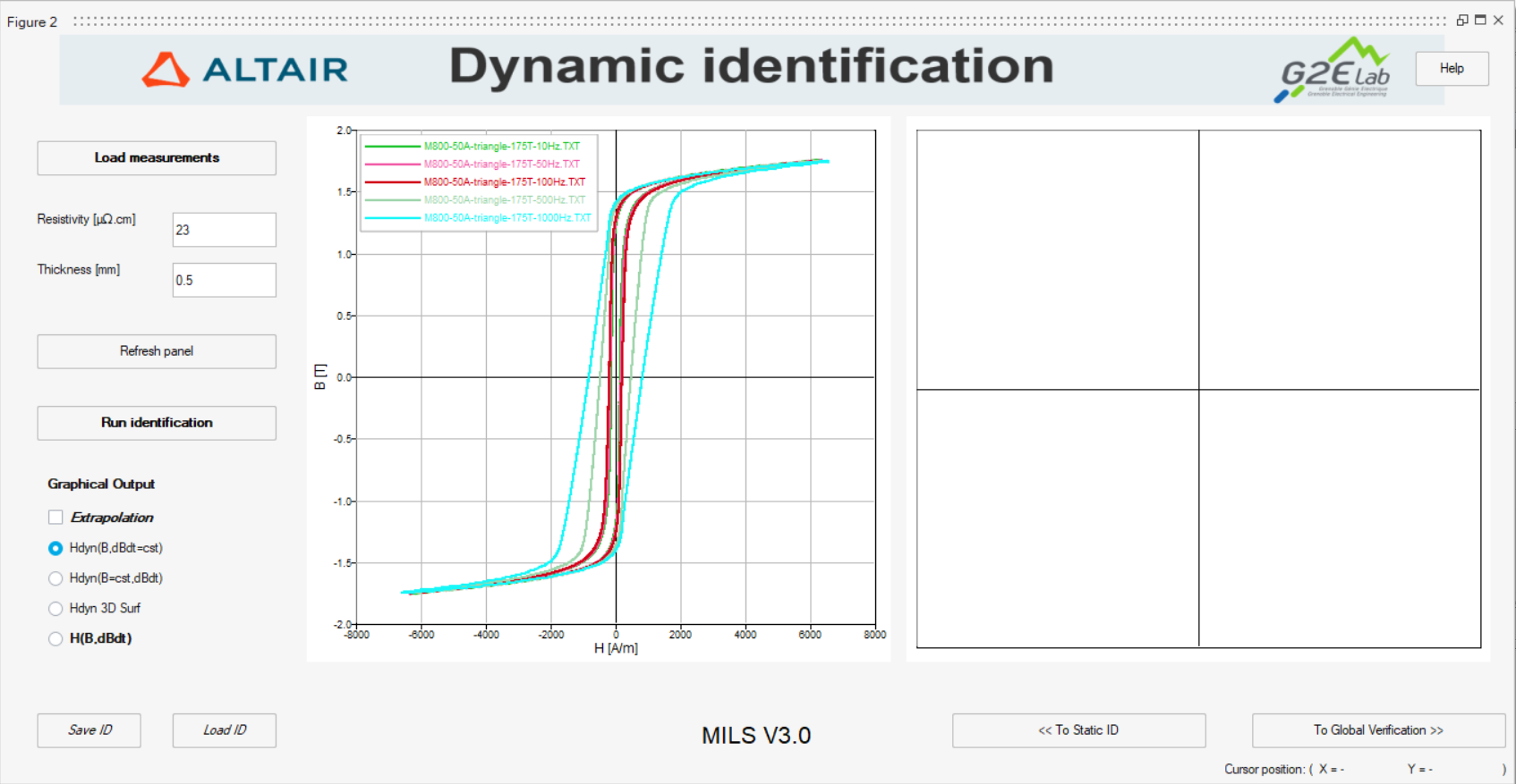

the steel sheet.Note: The files used in the dynamic identification step share the same format of the files used in Step 1.1 of the static identification. However, they are supposed to represent hysteresis loops measured under different experimental circumstances (i.e., higher frequencies and peak magnetic flux density reaching saturation). A detailed description of MILS's input formats and a discussion on the differences between the static and dynamic file sets are available here.Note: If the measurement files are loaded correctly, MILS will display the measurements provided by the user in the Curves preview window, as shown in Figure 2.
Figure 2. Hysteresis loop measurements displayed at the Curve preview window of the Dynamic Identification panel in MILS.

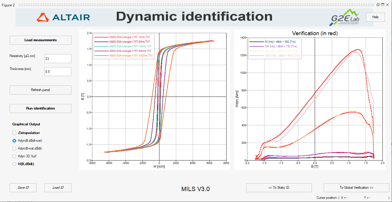

- Step 2.4: Launch the dynamic identification by clicking on the Run
identification button, which is labeled as 2.4 inFigure 1.Note: The results are displayed automatically in the Verification window, as shown in Figure 3. The curves in red represent the reconstruction provided by the identified dynamic model, while the colored curves correspond to the measurement files.
Figure 3. After a successful dynamic identification, the Verification window displays a comparison between the measurements and the fitted dynamic LS model.
