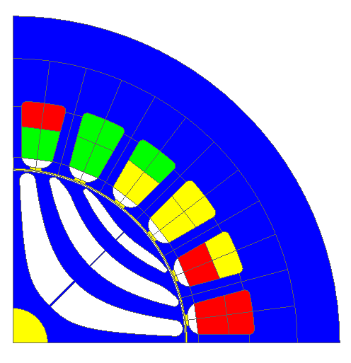

Let's consider the modeling of the following electrical machine represented by only one-quarter of the full device.
Figure 1. Four poles electrical machine with three current phases

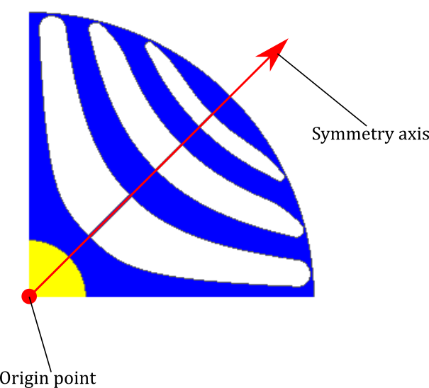

The symmetry constraint may be set as follows:
Figure 2. Origin point and symmetry axis for the one-axis symmetry constraint
The origin axis is set to (0,0) and the symmetry axis is set to (0.5,0.5).

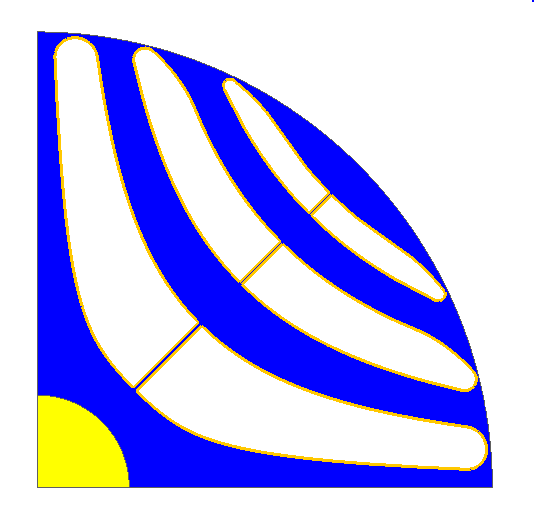

In the end, the lines where the nodes can move are selected as depicted in the figure below (the lines are surrounded in yellow):
Figure 3. Lines to be considered during the optimization process

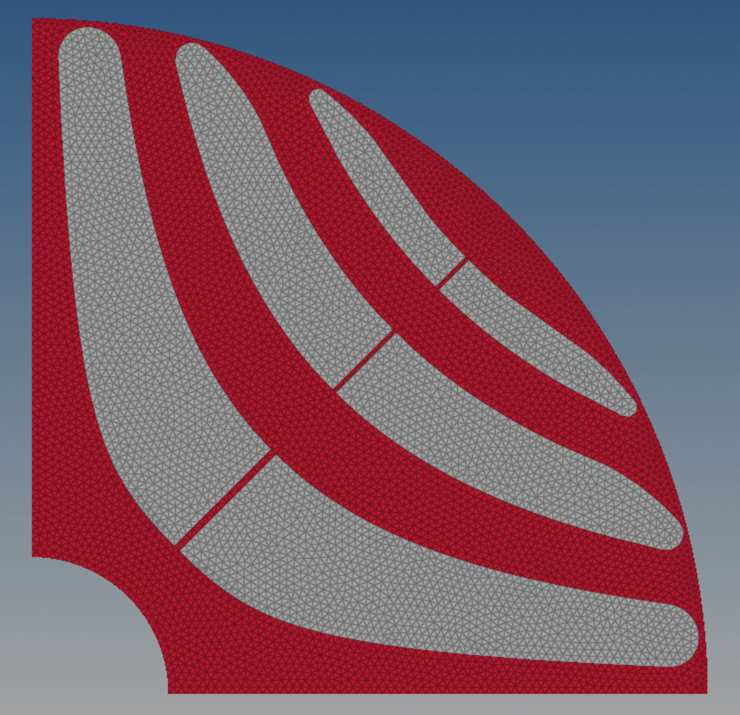

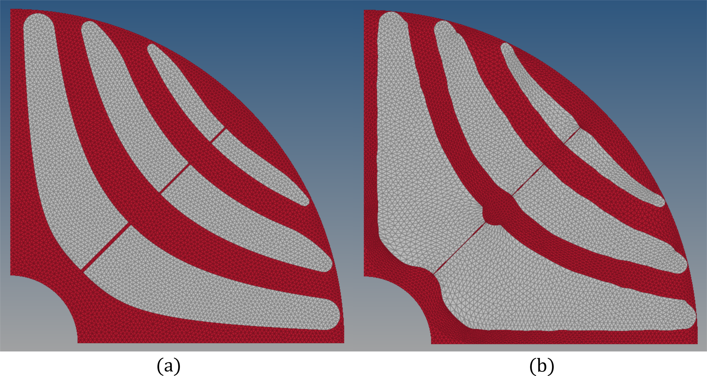

Using the Free-Shape Optimization, we obtain several files in the temporary folder (.wmv for HyperView) to see the results, check the mesh of the Project_OptimizationResults.FLU:
Figure 4. Initial design of the reluctance synchronous machine (a) and final design of the reluctance synchronous machine (b)
Even though the initial motor already has good performances, the use of Free-Shape Optimization brings remarkable improvements. As shown in Table 1, a 4.8% increase in the mean torque is achieved, with a rotor mass reduction of 20%. Figure 4 shows the initial and optimized rotor configuration.

Figure 5. Displacement of the nodes during the optimization process
