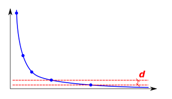

| Optimization tolerance (in percent) | Stops the optimization process when the objective value varies
(d) less than the tolerance value between two
iterations.Default value = 0.5%![]() |

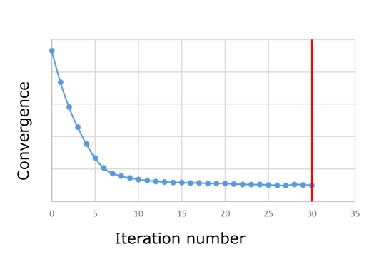

| Maximum number of iterations | Stops the optimization process when the maximum number of
iterations is reached if the convergence was not met.Default
value = 30![]() |

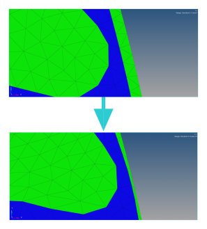

| Number of iterations before remeshing | Defines the number of iteration to complete before remeshing the design parts. Allows to improve the optimization by adding nodes and elements when these become of too poor quality following displacements. |

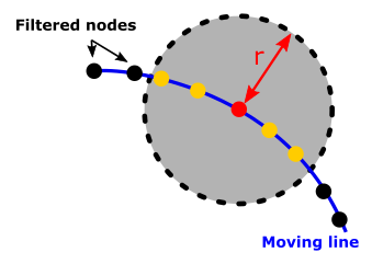

| Move limit | Define an area where the nodes can move, this area may be defined
by:
| Sensbilities filter | Define an area where the nodes will move in an average direction
composed of each node directions, this area may be defined as:
