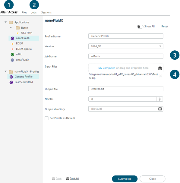

Launch a Simulation via PBS Access
- Browse to your PBS Access server and login.
- Click the Jobs menu and select
- Select the nanoFluidX version to be used and enter a Job name.
Select (or drag-and-drop) the input files to the browser so that they are
uploaded.
Note: It is possible to upload a *.zip file when there are many files or if the file size is large. This will be automatically extracted at runtime.
- Select the number of GPUs to use and click Submit job.

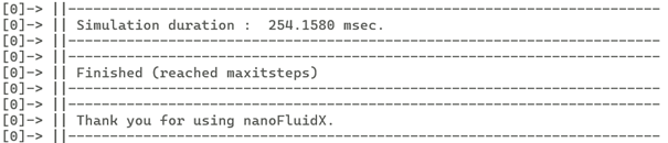

The test run is successful when the message
Finished (reached maximum steps)appears at the end of the PBS output file.Note: Simulation time may vary.Figure 2.
