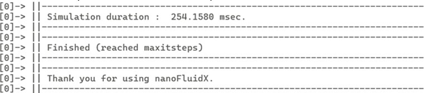

A successful test will produce output similar to the figure below.

nanoFluidX:nFX_SP -i dambreak_3D_H300_dx0p005_wt.cfg -m 10.
Finished (reached maximum steps) appears at the
end.Note: Simulation time may vary.
