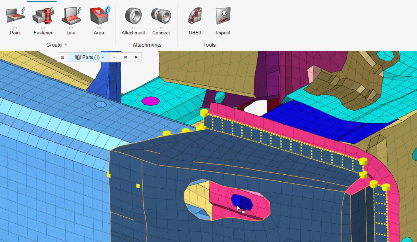

- Auto Area Tools
- This feature can be used to select Parts/Components and create Area
Connectors within the a specified Tolerance. The result will mirror the
result from the Auto Contact tool.

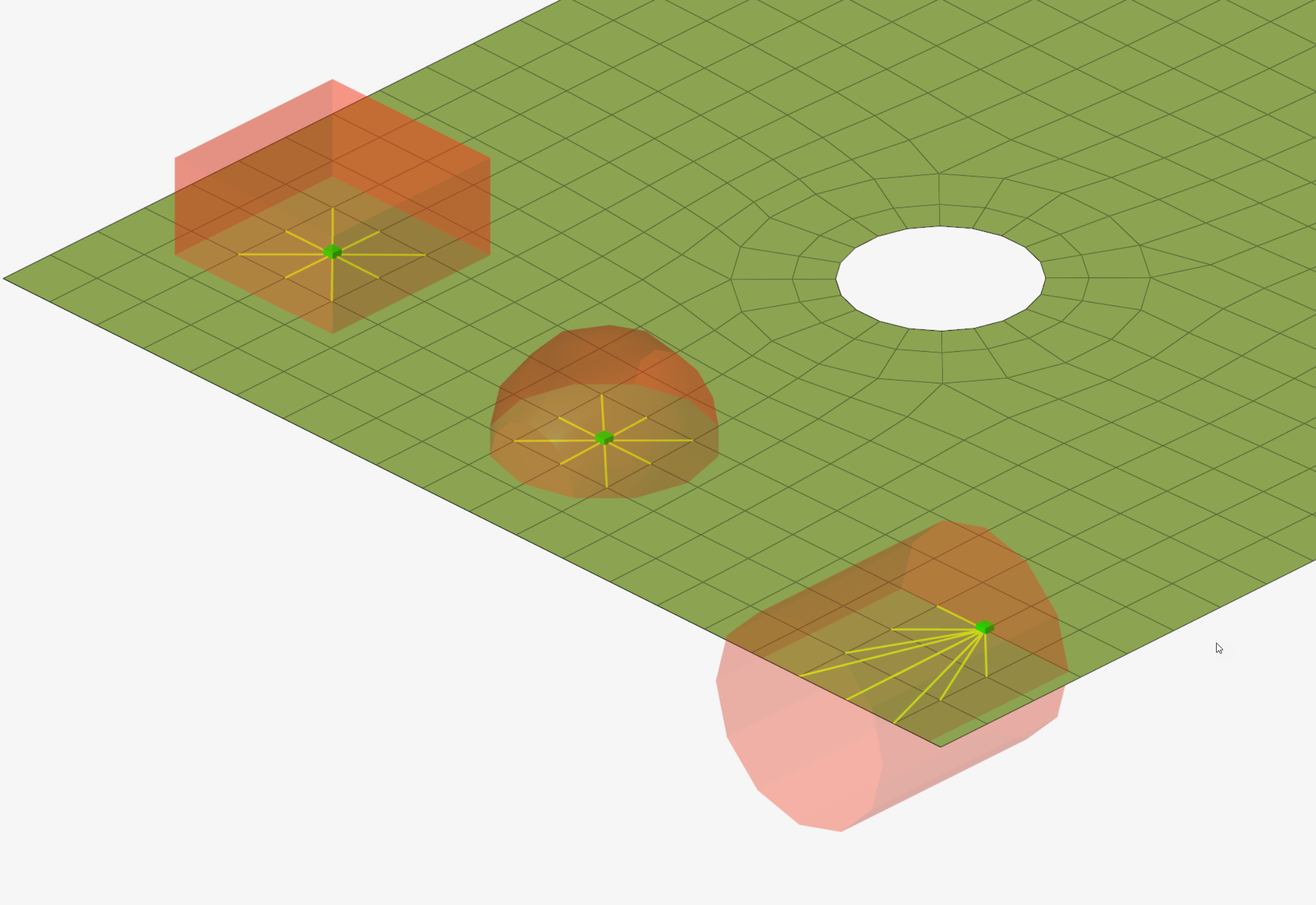

- Capture Shape Attachments
- These new attachment options allow a shape selection and dimensioning.
Any nodes within the selection on the part link is then selected. The
different shapes are sphere, box, and cylinder.

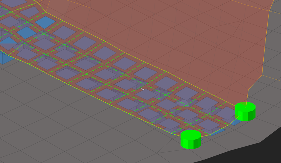

- Contact Connectors
- This feature can be used to create contacts from the connector. This
realization creates set-based contacts between areas identified by the
connector projection. This is supported from both line and area
connectors.
Figure 3.
