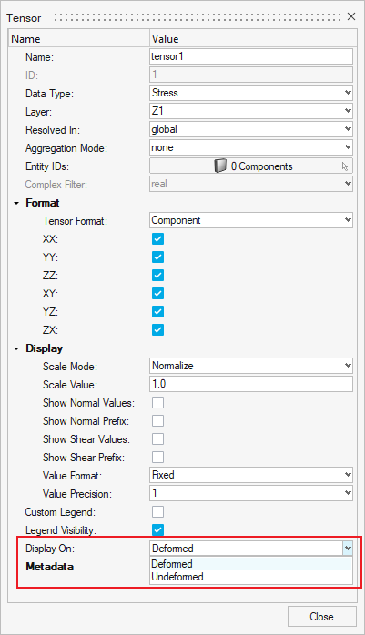

- Vector and Tensor plots can now be shown on undeformed or on deformed
shapes.

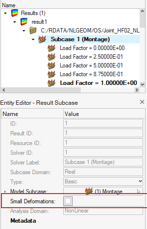

- A small/large deformation switch has been added to subcase entity.
- The Small Deformation check option has been added in the post preference page to control results query accordingly.

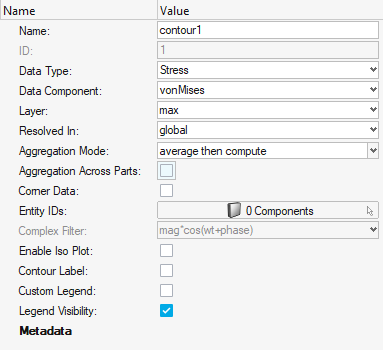

- A change has been made in labeling for averaging method to Aggregation Mode.
- The former set up as average = simple is now relabeled as average then compute.
- Mode compute then average has been added.
- Aggregation based on part boundaries has been added as an option to plot
control.
