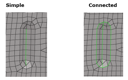

- Allow open features
- Orphan feature edges can be created with this option, as shown in Figure 2 by the Simple example.
