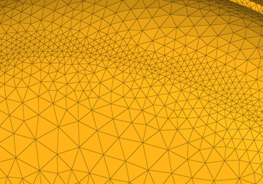

Figure 4. Input
Figure 5. Remesh result with feature angle 22.5
